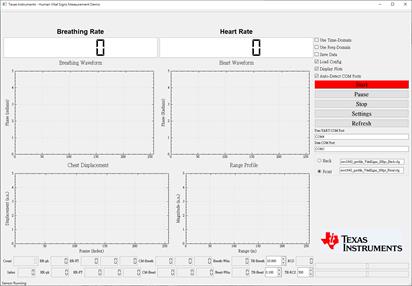

2. we used QT5.13.1  to open the code and do gui_source compiler. And then do execution.
   It cannot work well and GUI has no response. below is the message and photo
QT version =  5.13.1

and below is the photo
please advise what we miss or how to fix this issue
