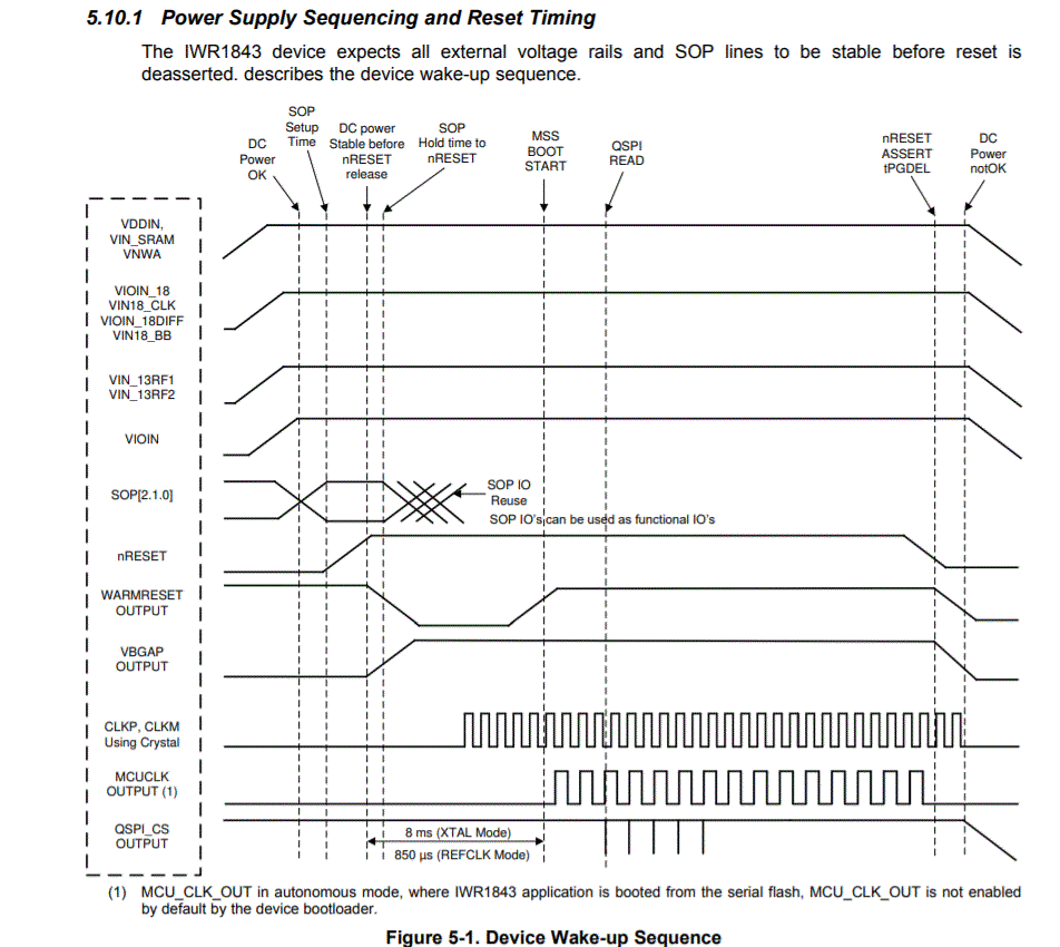

  • Hello David,
         Schematic doesn't have full information, i.e. Device has boot pins (SOP lines) these need to be defined at correct boot mode option during the NRESET release as shown in the below timing diagram.
    Could you please share how boot mode is configured during the NRESET release.
    After power supplies are stable, Boot configuration pins (PMIC_CLKOUT, SYNC_OUT and TDO) need to have weak pull up/down to device the boot mode prior (3-5msec) NRESET release. Could you please review the device Wake-up sequence requirement is met?

  • Hello Dave,
    After power supplies are stable, Boot configuration pins also known as SOP lines (PMIC_CLKOUT, SYNC_OUT and TDO) need to be asserted to right boot modes before reset is released.
    Is it possible to share how the SOP signals are driven?
    Thanks and regards,
    CHETHAN KUMAR Y.B.
  • Hello Dave,
    On the AWR device PMIC_CLKOUT is pin P9, SYNC_OUT is pin G13 and TDO is pin N13. NRESET is pin R3. These pins should all have pullups on your board, you can trace the pins to the pullups on your schematic to see where you should probe.
