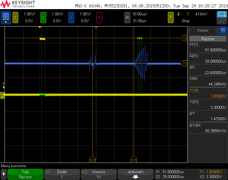

    Please send me plots of the START, STOP & COMPIN Pin.
  • Hi Bharat,
    I have two setups on which the results are almost same.
    First setup consist of TDC1000-TDC7200 EVM + Switching board and custom tube with US0019 by Audiowell.
    Second setup consist of MCU+TDC1000+TDC7200+Switching circuit on single PCB + same custom tube.
    Transducers are placed intrusively, faceing each other without any mirrors inside tube. Distance between transducers are nearly 80mm, TOFs at no flow are ~55us.
    I'm using 8-10 TX, 3Stops, 3rd level of PGA and 4th level of THS;
    Plots You asked for below.
    Edit: As you can see on COMPIN signal there is peak @~29us after first TX, I can see it on both EVM and my PCB. Do you know what could be the origin of this peak.

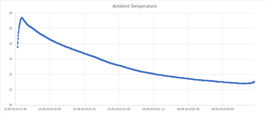

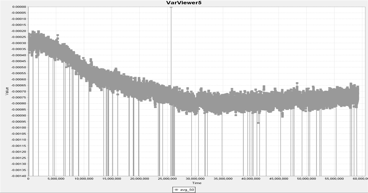

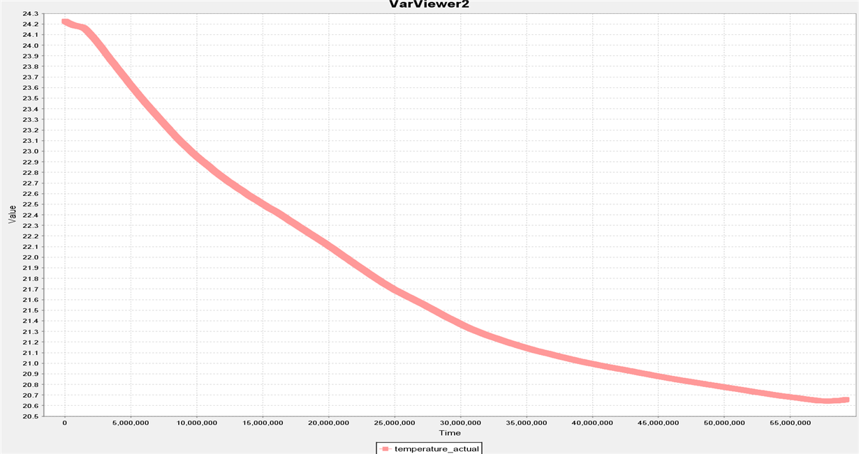

    I prepered test yeasterday which took 16hours. I was measuring and collecting dTOF and water temperature with TDC1000+TDC7200 and ambient temperature for reference. Here are my results (all times in miliseconds):
    1. Delta TOF, started with mean value -300ps. After almost 9hours stabilized at -800ps mean value. (Peaks in results are bug from collecting software not mcu firmware)
    2. Ambient temperature, and temperature from TOF. Both are similar but doesnt have shape exactly same as dTOF.

    4. Then I heated the water to 30degC, but still -800ps remained, but then when the temperaure was going slowly to 20degC level of dTOF was going back to starting point -300ps.
    5. I was heating both PCB and pipe when it's on -300ps level and almost nothing happens (changes smaller than 50ps of mean level)

    The signal that you see @ 29uS should be from the walls of the tube right between the 2 transducers or disturbances in the water/liquid.
    In order to avoid wrong readings due to such noise we can increase the number of Rx signal pulses to 4/5 (STOP pulses).

    ToF is something around 52us. On the plot I posted it was delta TOF at zero-flow (300ps to 800ps).
    Now I made some workaround for the problem:
    • For "regular" measurement I make just 7 TX pulses and I measure 4 & 5 Stop for best accuracy,
    • Once per X minutes I make "calibration" mesurement. It consist of 16TX pulses + extended autozero period to measure the signal in the further part of RX signal. As far as I observed further part of RX signal is more stable in case of more TX pulses. With calibrated measurement there is no temperature based drift and I'm able to zero regular measurement.

    Whenever there is zero-flow in the pipe any disturbance in the water/gas in the pipe can cause the device to report ToF such as the once's you see now.
    Hence we recommend the user to modify the PGA gain, Number of Tx & Rx pulses such that they receive stable readings.
    I understand that you get stable zero measurement result when you measure the signal at the further part of Rx signal. If this is the case then your initial measurements from Rx has some noise/ringing associated with it and that could be either from the wall sides/burst energy of the Tx signal that the Rx senses.
