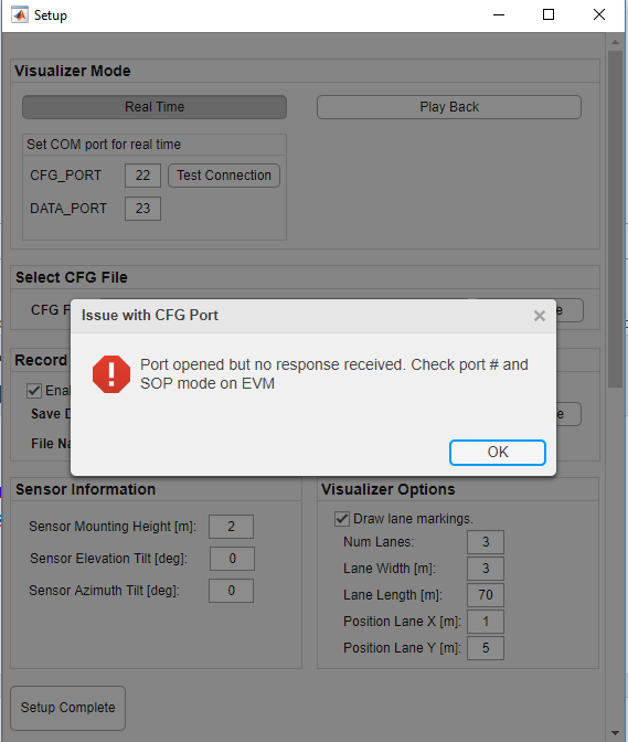

After flashing the board, I got an error when I run it as below
I have changed the mode to SOP[2:0]=001 when I run it. And the AWR1843 device is ES2.0 based on the reading of '502AD' on its surface.
My question is do I have to use IWR1843BOOST instead of AWR1843BOOST? I didn't see any functional difference between these two.

    Are you sure you have an 1843 Device? Only ES1.0 has been released and the package info should show '502AC'.
    The error you are seeing is related to the COM port availability. You should make sure you have the SOP mode set, then hit NRST. Also check that you don't have any other applications open that could be holding onto the COM port (close any other visualizers and Uniflash).
    You can test the COM ports by also opening a terminal (Tera Term) for the CFG port at 115200 Baud rate. Hit enter. Then type in version. You should see the device information come back.

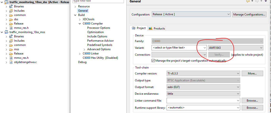

    I've confirmed the same issue as what you've observed. This lab was only tested for IWR1843 since it's part of the Industrial Toolbox. Can you try recompiling for AWR1843 by changing the device from IWR1843 to AWR1832 in both of the projectspecs and then importing to CCS and recompiling?
    device="IWR1843" -> device="AWR1843"
    Amanda
    I tried to rebuild the project with AWR1843 configuration as below.
    I got the same error as before.
    Would you please try to rebuild the project with AWR1843 configuration?

  • I tried what you said to check the version through COM port. It failed. With flashing the .bin file under C:\ti\mmwave_industrial_toolbox_4_0_0\labs\out_of_box_demo\18xx_mmwave_sdk\prebuilt_binaries, I can get the correct connection through COM port.
