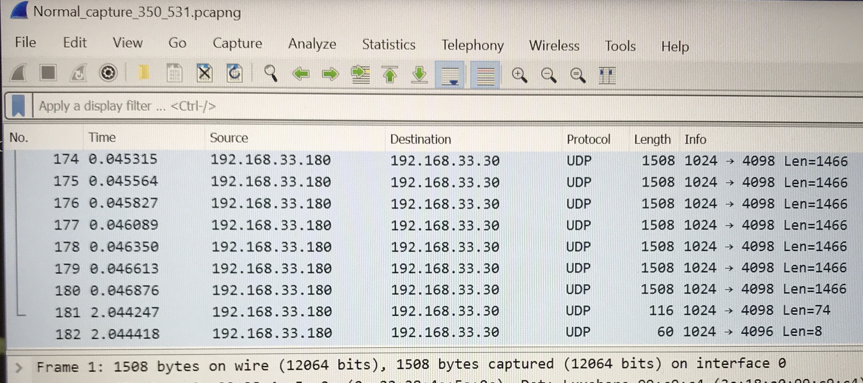

I'm having the problem using the DCA1000EVM for extended periods of 3-4 hours. The unit runs reliably for for some number of hours -- usually 3-4 though the specific amount of time varies. While working the unit sends me Ethernet packets reliably. For example, right now the unit is configured to send me 182 packets of data including the final "end of frame" message:

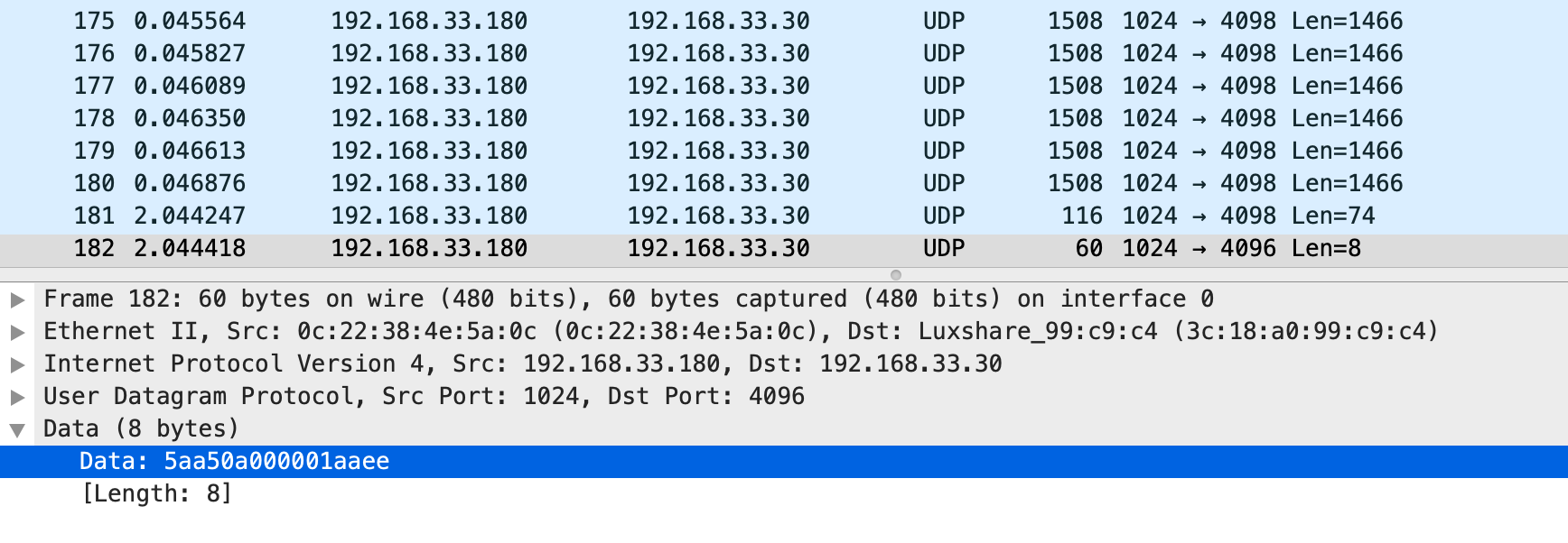

Here, packet #181 is the last data packet. Packet #182 is the end of frame message. We know this because it is addressed to the command port 4096.

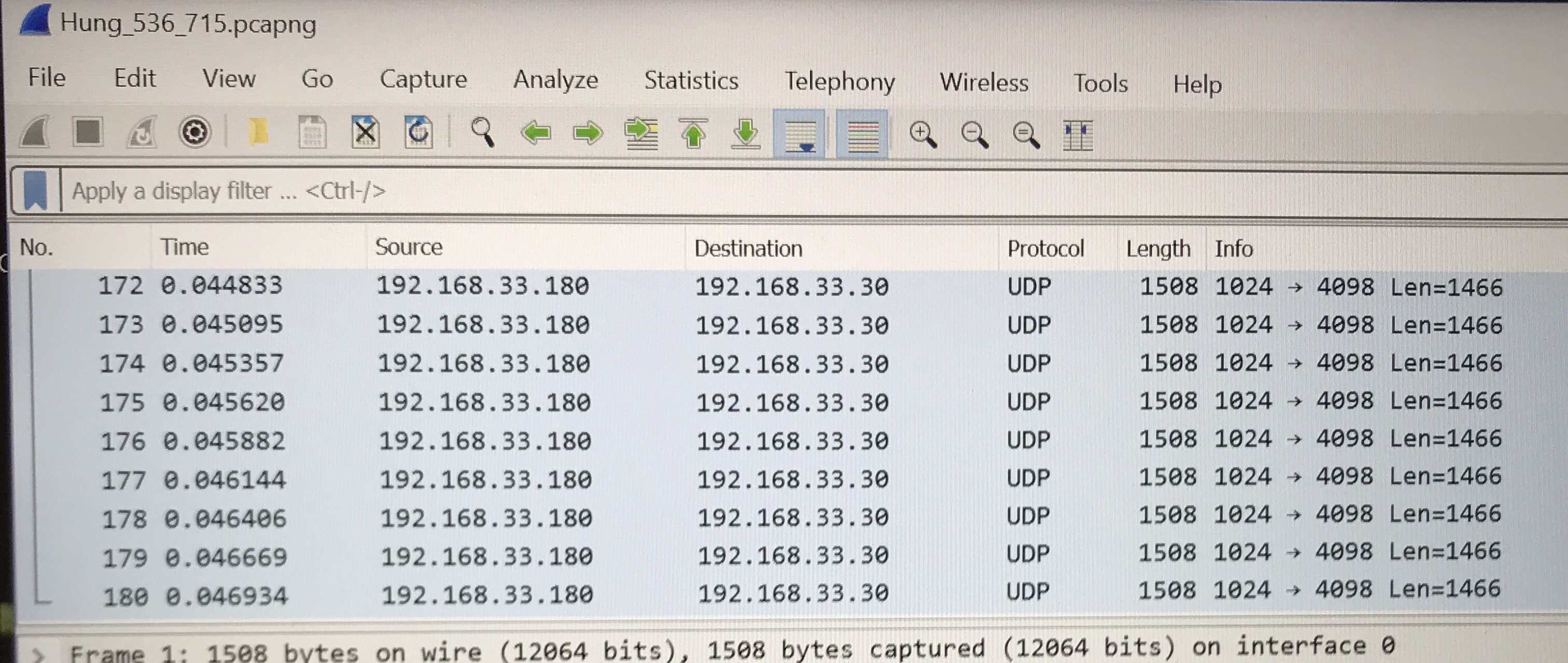

After running successfully for 3-4 hours the system will transmit all but the last data packet and not transmit the end of frame message:
Here, we only received 180 packets. My system then hangs indefinitely waiting for the end of frame message.
I'm able to reproduce this very consistently. I do not think this is a network connectivity issue. The DCA1000EVM is plugged directly into a dedicated Gigabit Ethernet interface. Not a single other packet out of millions is dropped.

    By "end of frame message" what I mean is the packet containing the data "5aa50a000001aaee". This packet is sent asynchronously at the end of every normal data transfer.

    In addition, note that the sequence "5aa50a000001aaee" is received from the DCA on the command port 4096, not the ADC data port 4098. Furthermore, we receive that exact sequence bit-for-bit at the end of every frame capture thousands and thousands of times. This makes me think these are most likely not ADC samples.

    Thank you for providing more details. The sequence you are mentioning is a response from the DCA1000 on a FGPA version get command. Its not related to a radar frame.

    Sorry that does not correspond to FGPA version get command, but is a status response from the DCA1000.
    Could you help me with more details on how you configuring the DCA1000 and what is the configuration you are using?
