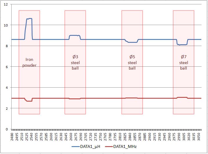

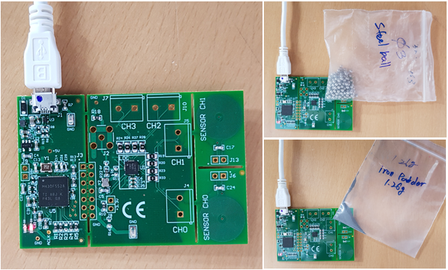

    Please review the test results below.
    Waveform when iron powder, steel ball(Ø3, Ø5, Ø7) are attached
    The red shadow areas show the waveform changes when iron and steel ball are attached and removed.
    In case of iron powder and Ø3 steel ball, inductance is increase and Ø5, Ø7 steel ball makes inductance decrease.
      iron powder Ø3 steel ball Ø5 steel ball Ø7 steel ball
    inductance 2.003 μH 0.3849 μH -0.2819 μH -0.5023 μH
    frequency -0.2953 MHz -0.0652 MHz 0.0499 MHz 0.0907 MHz
    Can we change the threshold at which the output value is converted?
    For example) The output direction is converted between Ø3 steel ball and Ø5 steel ball.
                          Can we make the converted point at between iron powder and Ø3 steel ball value?
    Thank you for your patience waiting for a reply; I was on vacation last week.
    It's not expected behavior for the metal target to make the sensor inductance increase (so it's not possible to change the threshold where the response inverts). Metal targets should always make the inductance decrease as long as eddy currents are able to form. I suspect that for the smaller steel balls and the iron powder the eddy currents do not form well, so you are seeing more of a capacitive response than an inductive response. You can see a similar response by touching the coil with your finger.
