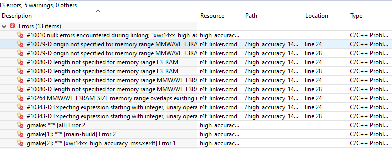

  • Hi Jitendra,
    We installed SDK v2.1 and tried rebuilding the project using CCS unfortunately we got 13 errors(screenshot attached).
    What could be the issue? How to resolve this?
    Divya Harikumar
  • Hi Divya,
    Please follow these steps to migrate AWR1443 high_accuracy application to mmWave SDK 2.1 version
    1. Goto CCS project properties->Build->ARM Compiler->Predefined Symbols
        add new pre-define 'MMWAVE_L3RAM_NUM_BANK=6' and 'MMWAVE_SHMEM_BANK_SIZE=0x10000' (without any space)
    2. sensor_mgmt.c: change MMwave_open function parameter
    if (MMWave_open (gMmwMCB.ctrlHandle, &gMmwMCB.cfg.openCfg, NULL, &errCode) < 0)
    3. In main.c: change structure rlRfInitomplete_t to rlRfInitComplete_t
    4. Remove 'imageCreator/${MMWAVE_SDK_DEVICE}/out2rprc/out2rprc.exe ' from CCS project properties->Build->Steps-> Post-build steps
    Jitendra

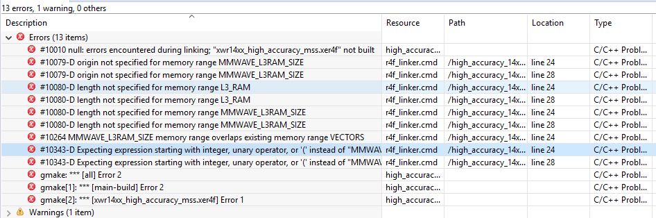

    Following errors occured :
    How can we fix this?
    Divya Harikumar
  • Hi Divya,
    Above change, I have suggested based on SDK 2.1 version.
    Please select SDK version as 2.1 in the CCS project properties->General->Products->mmWave SDK..
    Jitendra
  • Hi Jitendra,
    I have made the changes for sdk v2.1 as per suggestion but unfortunately error still exists.
    Divya Harikumar
  • Hi Divya,
    On top of those settings, please add these also in the CCS project properties
    Build->ARM Linker->Advacned Options->Command File preprocessing.-> Pre-define MACRO
    MMWAVE_L3RAM_SIZE=0x40000
    MMWAVE_SHMEM_TCMA_NUM_BANK=0
    MMWAVE_SHMEM_TCMB_NUM_BANK=0
    And in the Project Properties->Build-> Steps-> Post-build Steps, delete last parameter of first command.
    ${COM_TI_MMWAVE_SDK_INSTALL_DIR}/packages/scripts/ImageCreator/out2rprc/out2rprc.exe ${MMWAVE_SDK_DEVICE}_high_accuracy_mss.xer4f ${MMWAVE_SDK_DEVICE}_high_accuracy_mss.bin
    Jitendra

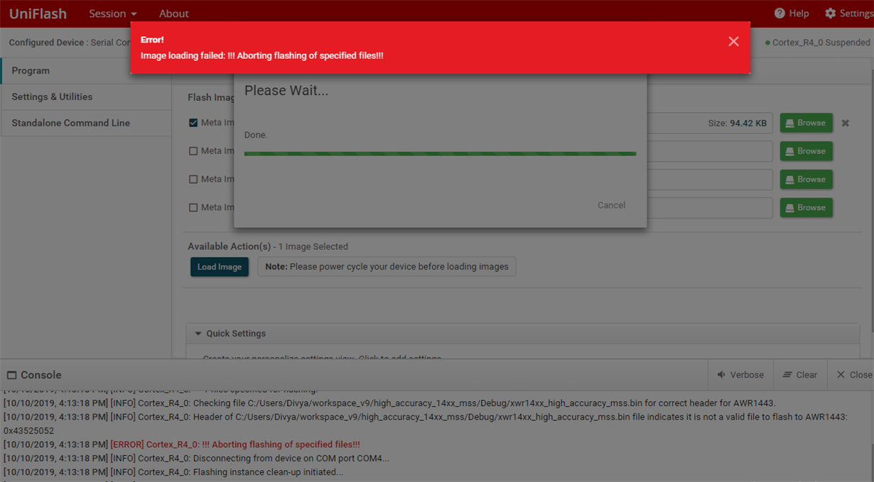

    The bin was succesfully created but i couldn't flash it into the device as it aborts with the following message.

  • Hi Divya,
    You need to add these post-step commands in the CCS project properties.
    Project Properties->Build-> Steps-> Post-build Steps (remove all the cmds and add these)
    ${COM_TI_MMWAVE_SDK_INSTALL_DIR}/packages/scripts/ImageCreator/create_ConfigRPRC/create_ConfigRPRC.exe -s 0x00000006;${COM_TI_MMWAVE_SDK_INSTALL_DIR}/packages/scripts/ImageCreator/out2rprc/out2rprc.exe xwr14xx_high_accuracy_mss.xer4f xwr14xx_high_accuracy_mss.tmp;
    ${COM_TI_MMWAVE_SDK_INSTALL_DIR}/packages/scripts/ImageCreator/multicore_image_generator/MulticoreImageGen.exe LE 37 0x00000006 xwr14xx_mmw_demo.bin 0xCF910000 ar1xxx_conf.bin 0x35510000 xwr14xx_high_accuracy_mss.tmp 0xb5510000 ${COM_TI_MMWAVE_SDK_INSTALL_DIR}/firmware/radarss/xwr12xx_xwr14xx_radarss_rprc.bin;
    ${COM_TI_MMWAVE_SDK_INSTALL_DIR}/packages/scripts/ImageCreator/crc_multicore_image/crc_multicore_image.exe xwr14xx_mmw_demo.bin xwr14xx_mmw_demo.tmp;
    ${COM_TI_MMWAVE_SDK_INSTALL_DIR}/packages/scripts/ImageCreator/append_bin_crc/gen_bincrc32.exe xwr14xx_mmw_demo.bin;
    After this build, you need to flash 'xwr14xx_mmw_demo.bin' file which will be around 127KB.
