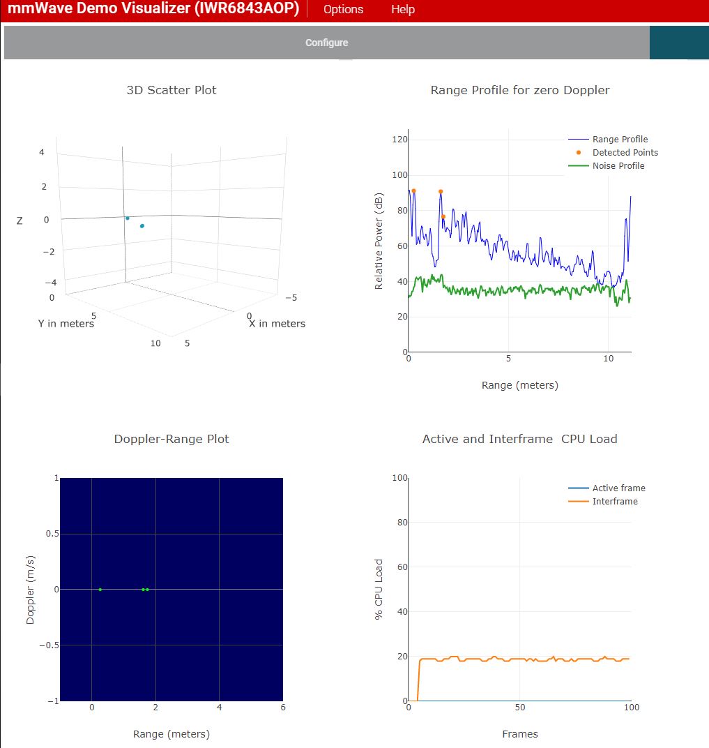

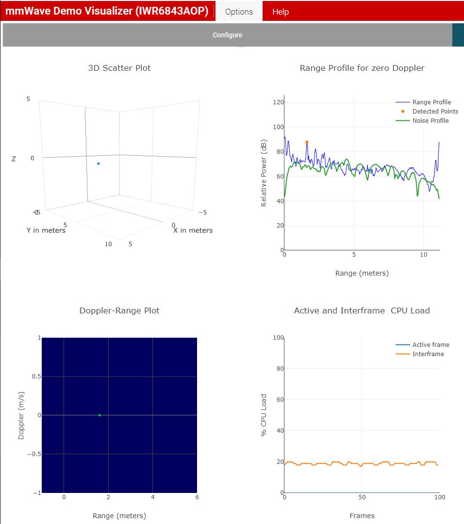

My problem is that the noise level is jumping from low to high periodically and in the point could I only see single points e.g. when pointing to a wall I just see 1 point and it is not constantly visible. I have try all different configurations but no change. Displaying the Doppler heat map I also observe this "jumps" in the back ground (from dark blue to yellow).

  • Rainer,
       Could you please post the picture of your observation?
    Thanks and regards,
    CHETHAN KUMAR Y.B.
  • Hello Chethan,
    here the required images. In the mean time I have installed the IWR6843 ISK with booth board - besides some problem with the COM connection I do not see this behavior.
    Device "cold" just plugged to USB port.
    Device running for 1 - 2 minutes and the "jumping" of noise starts image 1 "low noise" image 2 "high noise" environment not changed

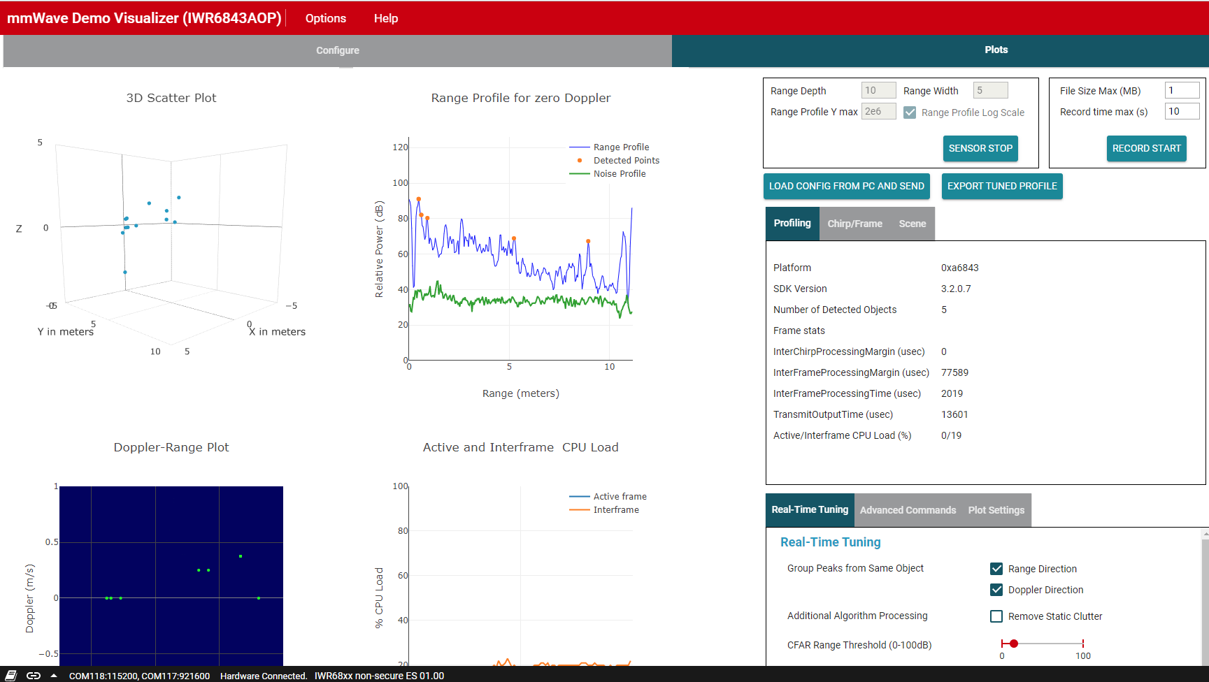

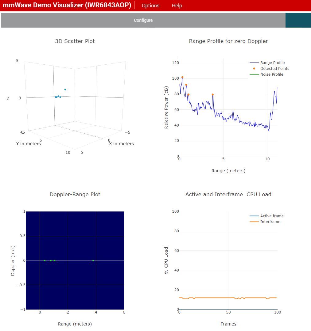

  •    Could you please post the picture of your observation?
         Below is the image of the noise profile.
