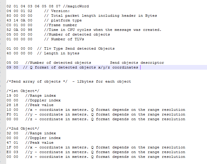

We are running mmwDemo lab on 1443 ES3.0 device with mmwave_sdk_2_01_00_04.
we are able to receive the data. In that data we can able to find the Number of objects detected and their parameters.
Range Index, Doppler Index, Peak Value, X,Y,Z coordinates. How to calculate the range of each detected objects using these parameters? is there any formula for it. Please share it.
