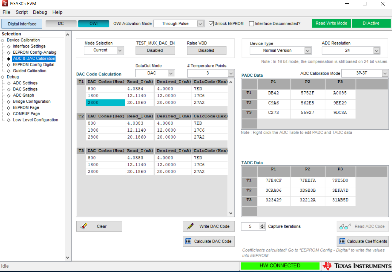

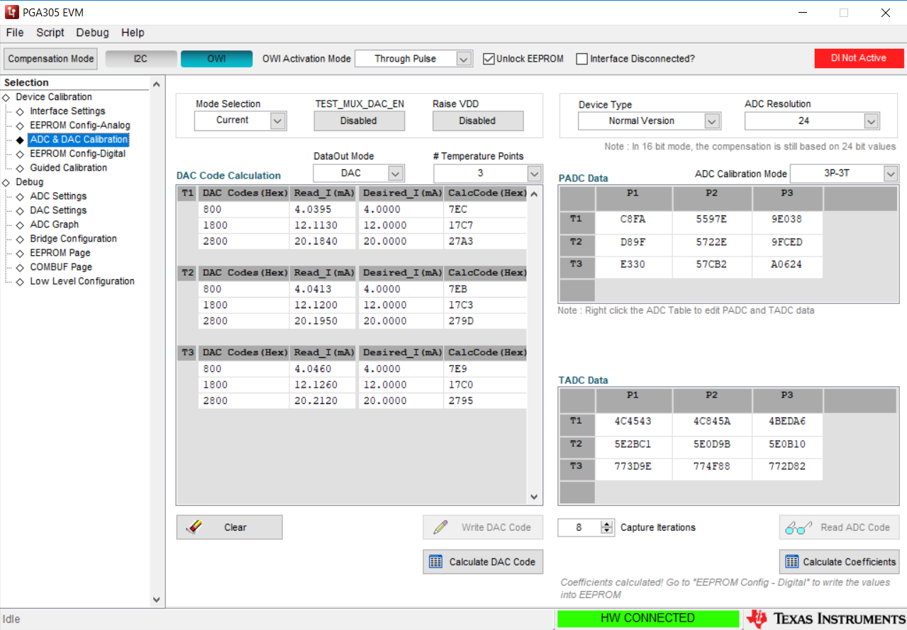

    Additionally could you post a screen capture of the ADC&DAC calibration tab with the data that you collected for the calibration procedure? When you say that the full scale output is way off, do you mean that at the maximum pressure input, the DAC output is not at your expected value? Is the DAC output higher or lower than you expect, and does this offset stay the same for different pressure inputs, or is there some gain component to the error?
  • Below is the ADC&DAC calibration tab with the data collected.
    The DAC output at each temperature is the same.  The PGA evaluation board, and therefore the PGA305 chip, is outside the oven so this makes sense.
    Below is the data I collected at 50 degF after the coefficients were calculated and downloaded.  Please note that this is a 4 and 20 milliamp current loop.  I am currently collecting additional data at 101 degF and can post those results as well if it will help.
      Measured                      Expected
            Pressure                   Output                          Output
       (% of full scale)           (milliamps)                 (milliamps)
                   0                             4.095                         4.000
                   50                          12.363                        12.000
                 100                          20.768                         20.000

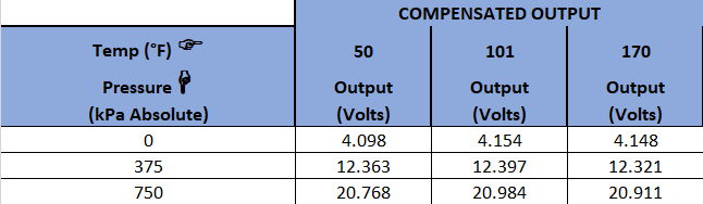

  • The rest of the data collected through temperature is as follows...

    Thanks for the additional information. It looks like the calibration was completed successfully, so at this point the issue lies in accuracy of the calibration. The most common problem I see is that the temperature at which the calibration is validated is not exactly the same as the temperature at which it was calibrated. How long do you soak your test setup at each temperature point? For the best results, the temperature should be allowed to settle for 30 minutes to 1 hour after reaching the desired temperature. The simplest way to check would be to monitor the temperature through the GUI using the ADC Graph page. Once the temperature reading levels off for a while you can begin to take your calibration measurements. The same should be done when validating the calibration. The temperature should be allowed to settle.
    I would also suggest measuring the raw TADC data when validating the calibration to see if the temperature data matches the temperature at the calibration point. If the temperature is off, you will see some deviation from the expected output. This can also be useful for the pressure data, although the temperature is usually the more volatile of the two.
    Finally, make sure that the PGA305 is powered on for the entire calibration procedure. There is some small amount of self-heating that can affect the output (or the temperature input in the case of using the internal temperature sensor).

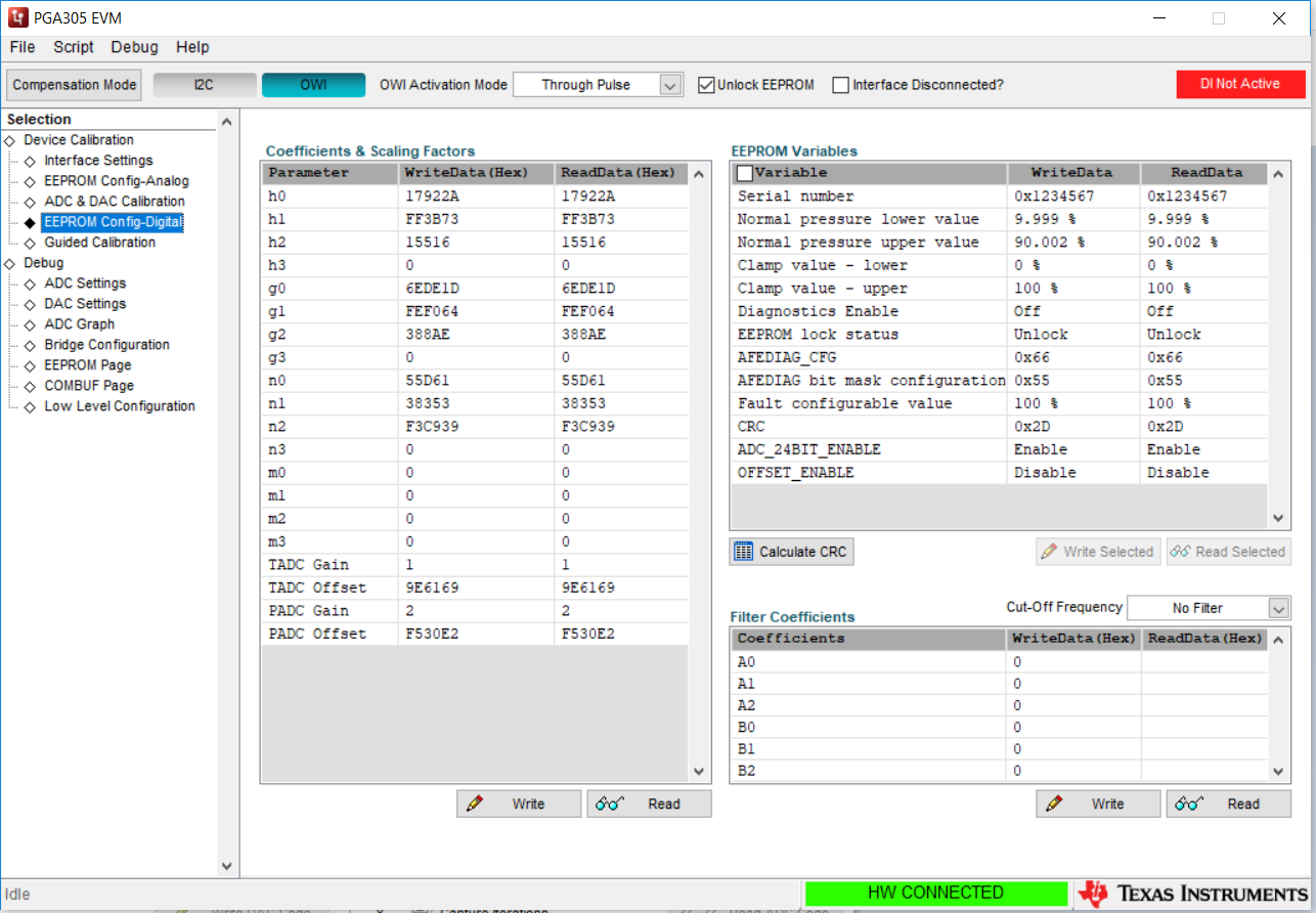

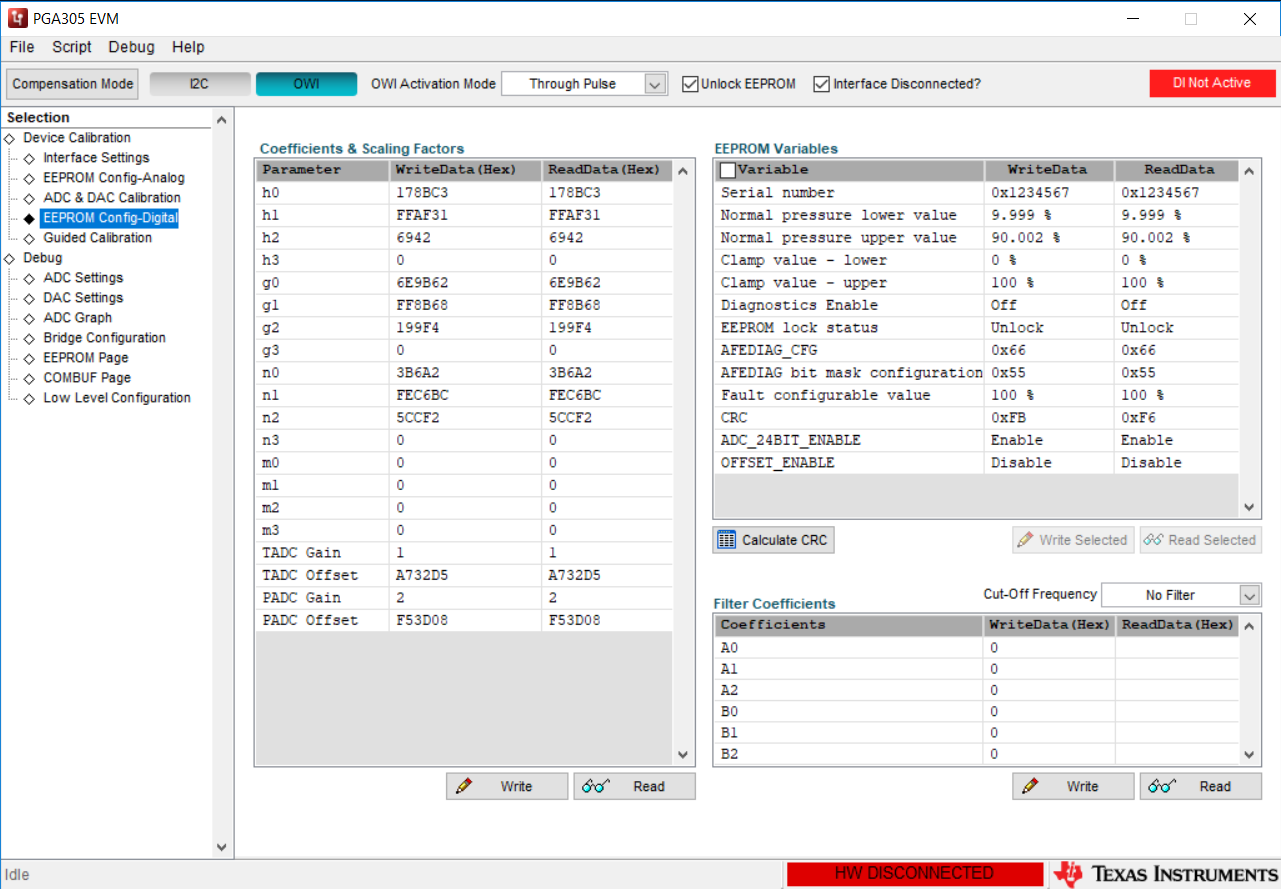

    In my setup the current source continues to supply the temperature sensor even when the device is placed into compensation mode. Can you please post the Analog EEPROM settings, and the full EEPROM map? You can save a copy of the EEPROM map on the EEPROM page by reading the data and then right clicking to save the data.
  • I restarted the GUI and the problem went away.  However, after trying to recompensate the unit throught temperature, 50- 110-170 degF, I am still not able to get good data when I switch into compensated mode.
    Attached are screen shots of the data and pressure vs milliamp output at 50 degF.
    The outputs should be 4 mA, 12 mA and 20 mA but the 12 and 20 mA outputs are significantly off.  I have been trying to compensate this unit for over a month and have not been able to get good results.  has the software been fully tested through temperature?

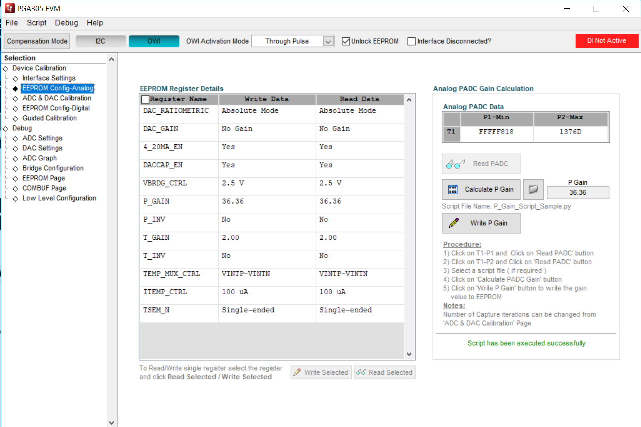

    Also, the PGAIN setting that you are using is likely too low. The script that generates a PGAIN on the Analog EEPROM page currently has some issues, and it will always suggest 36.36. You should be able to double that gain at least (since the digital PADC Gain is after the calibration is being set to 2), and maybe increase it more. This should help with the calibration accuracy.
  • Thank-you for the information. I will adjust the gain.  This would increase the resolution but it seems unlikely that this would cause a 12% error at full scale as I'm seeing.

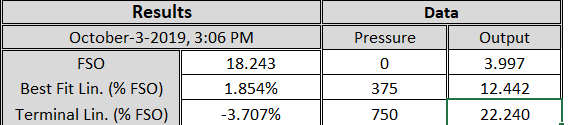

    The data I posted showed that the full scale output of the unit was over 22 milliamps after compensation when it should have been 20 milliamps.  The compensated data of 22 milliamps was collected at the same temperature the uncompensated data was collected at and right after it was collected.  This was the last of 3 temperatures so the uncompensated data was collected, the calculations performed for the coefficients, the coefficients were downloaded, the unit was switched to compensated mode and the compensated data was collected. I am not clear why there would be error

    Since the calibration is performed in digital interface mode, and you are reading the raw PADC and TADC data then it won't matter what is programmed into the coefficient space (including the digital PGAIN and TGAIN).
    Which digital interface are you using, I2C or OWI? If you are using OWI, what is your final system VPWR voltage? If it is higher than 5V, do you switch to that voltage after performing the calibration and before you validate the results of the calibration?
    There is a small amount of self-heating that can occur in the PGA305 at high DAC outputs, and when there is a higher VPWR voltage. This would typically only affect the results if the internal temperature sensor is used, but since you are using an external sensor it's not very likely. One way you could test this is to set your max DAC output to a smaller value and see if the accuracy improves. The self-heating should be reduced quite a bit with the device soldered onto a board with the powerpad connected.

  • I finished the run with P_ADC gain increased as per your suggestion.  Now the full scale output of the PGA305 is around 18.5 milliamps.  It still has significant error but the other direction.  (It was at 22 milliamps and should be 20 milliamps)
    You said the GUI has been tested for temperature.  Has it been tested using 3 temperatures for the compensation?  It really seems like there is an error in the calculations.
