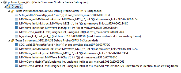

We are using IWR6843 ES1.0 samples on custom PCBs very closely following the IWR6843ISK layout & BOM, running the lab0015 firmware from mmWave industrial toolkit 3.6.2.
Startup is not reliable, on some boards the firmware only sometimes reaches the point of starting the CLI.
I have now built the firmware from source in CCS, and using the XDS110 debugger I have identified that when this happens, both the DSS and MSS cores are hanging in SOC_waitBSSpowerUp at the following line:
while (CSL_FEXTR(ptrSOCDriverMCB->ptrTopRCMRegs->SPARE0, 18U, 16U) != 0x7)
with call stacks as shown below:

  • Hi Martin,
    I am discussing this with other engineers on my team, we will have a response soon.
    Justin

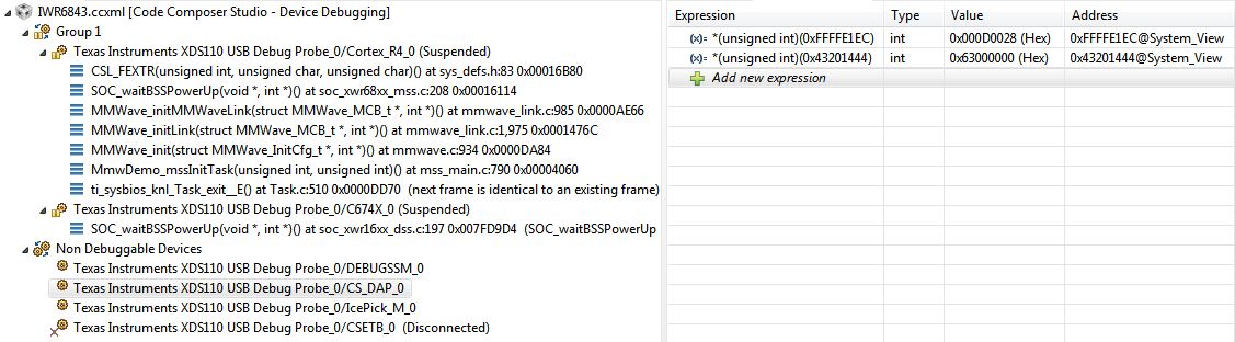

  • Hi Martin,
    Thanks for the confirmation.
    Could you please follow the debug instructions provided in the following response and provide the requested register values from the non-working board(s)? Please flash the lab0015 binary from Toolbox version 3.6.2 as you have been using so far:
    https://e2e.ti.com/support/sensors/f/1023/p/844780/3124873#3124873
    -Nitin
  • Hi Nitin,
    I get the same values as reported by Lola, see below:
    Martin
  • Hi Martin,
    Thanks for providing the requested debug information. The values you provided indicate that this IWR6843 ES 1.0 device has an irrecoverable failure during boot-up. We have identified that this issue affects some IWR6843 ES1.0 devices and it has been resolved in ES2.0 devices.
    I would suggest you to verify the problem signature on non-working boards and if it matches the above, please replace those devices with ES2.0 silicon which is now available on TI.com.
    -Nitin
