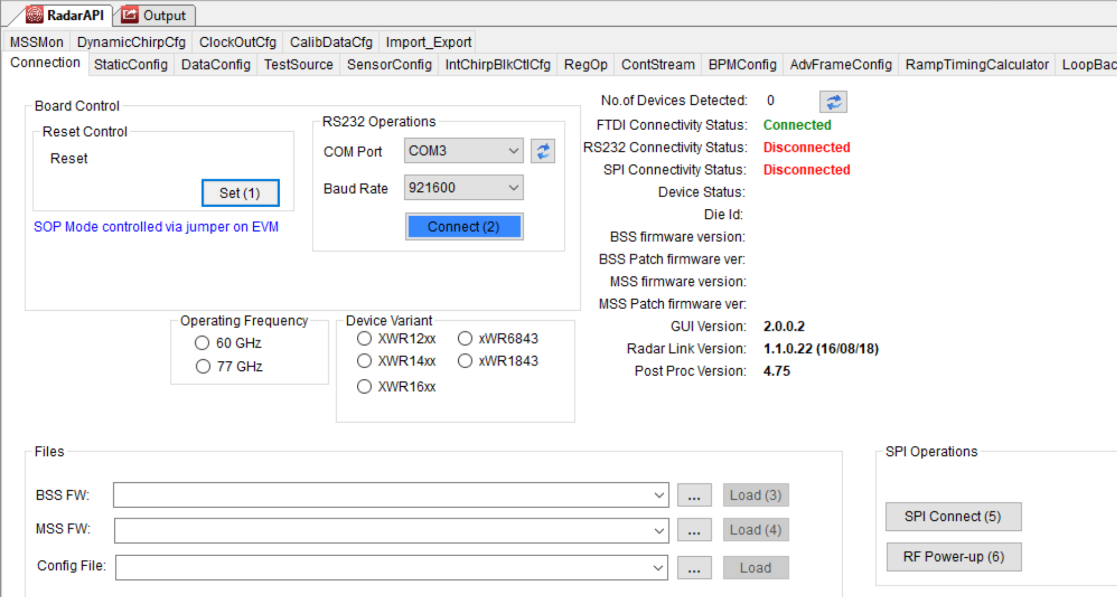

DO NOT CLOSE THIS POST, CLOSE OLD ONES BUT NOT THIS ONE. I have been trying for the last three months to get pc to detect dev packs without any luck. Support has failed to provide me with a solution. I am using
5V 3A power source for dca1000evm
5V 3A power source for awr1642
Since each device has it's own power source, the switch of dca1000evm can not be turned ON. If it is own, dca1000evm would start heating up fast.
windows 10 (64 bit)
USB Hub with its own power source
USB Network Adapter, USB 3.0 to RJ45 Gigabit
Mathwork run time engine(8.5.1)
Wmwave, Uniflash, code compressor
Stellaris_FTDI-2_06_00 drivers
IP of ethernet has changed to 192.168.33.30
Red and green lights are blinking when connects dca1000evm to awr1642.
I know upper port for dca1000 should not be connected but that was for testing.
Problem: PC does not detect drivers of DCA1000EVM. there are SEVEN drivers and I have only two(see device manger picture). I need a solution, please do not tell me an obvious answer(I Have been trying for three months and tried 5 PC's)

    We need to determine why you can't see the DCA1000 FTDI COM ports on your PC.
    Please try without any USB hub
    Before you do anything else you need to see the COM ports as shown in the training slides.
    Notice that the SOP jumpers on the AWR1642EVM are not correct. This will be an issue later.
    Please see correct settings in the DCA1000 training slides
    I checked with the team and we have used the DCA1000 with USB hub many times with no problem.
    Could you check the voltage level at the ftdi chip? Schematics of the DCA1000 are available on the EVM page.
    We need to determine if the board is functional or not
