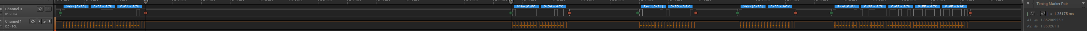

  • Ratheesh -
    Please double check with scope or logic analyzer that you are seeing (click on image to enlarge):
    also, hand soldering the device is not recommended. What was temp of the iron? Did you use no clean flux? Did you cover the part with polyimide tape before soldering? How will the DAP be connected?
