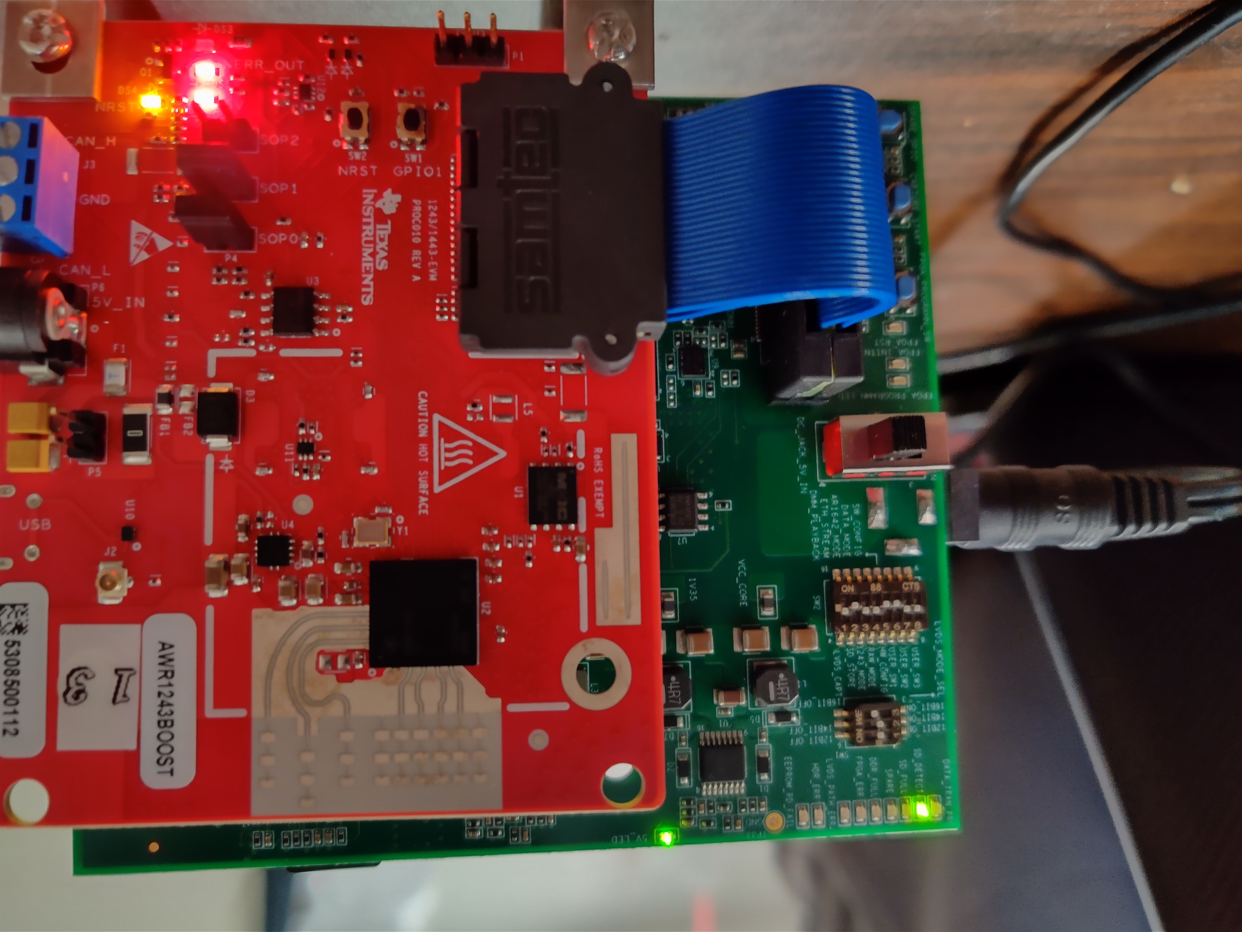

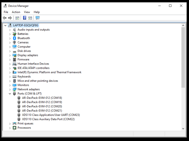

Hi, I have been using a DCA1000 with the AWR1642 and I have an issue with mmWave Studio detecting the board consistently. Most of the time I have to restart mmWave studio many times before the DCA1000 board is actually detected and sometimes even when it's detected, it might not be able to read the data I am trying to collect so I would then have to restart mmWave studio many more times before I can read in any sort of data. I can usually get through all the other parts with connectivity and configurations and the FPGA version, but when I trigger the frame it would either gray out the boxes until I close mmWave studio or it would start and end the triggering process but output an adc file that is 0 bytes. Is there some wave to resolve this issue?
Weilung
    "I have an issue with mmWave Studio detecting the board consistently"

  • I have similar issues using a 3A power supply. The board is not detected and when it is I am unable to use it. This issue has been consistent among different boards I have and different PCs where I have test them. Any advice?

    Hey, when I try to click the RF Power-up button, it fails.
  • Weilung,
    You are attempting to load firmware to your AWR1642 device that is built for a different device. You are trying to load the firmware for AWR1243 and AWR1443 to your device. Make sure you are loading the firmware for AWR1642.
    In the latest mmWave Studio release, MSS and BSS firmware for AWr1642 is included in the installation.
    It also looks like your RS232 connection does not complete successfully based on the logs you uploaded.

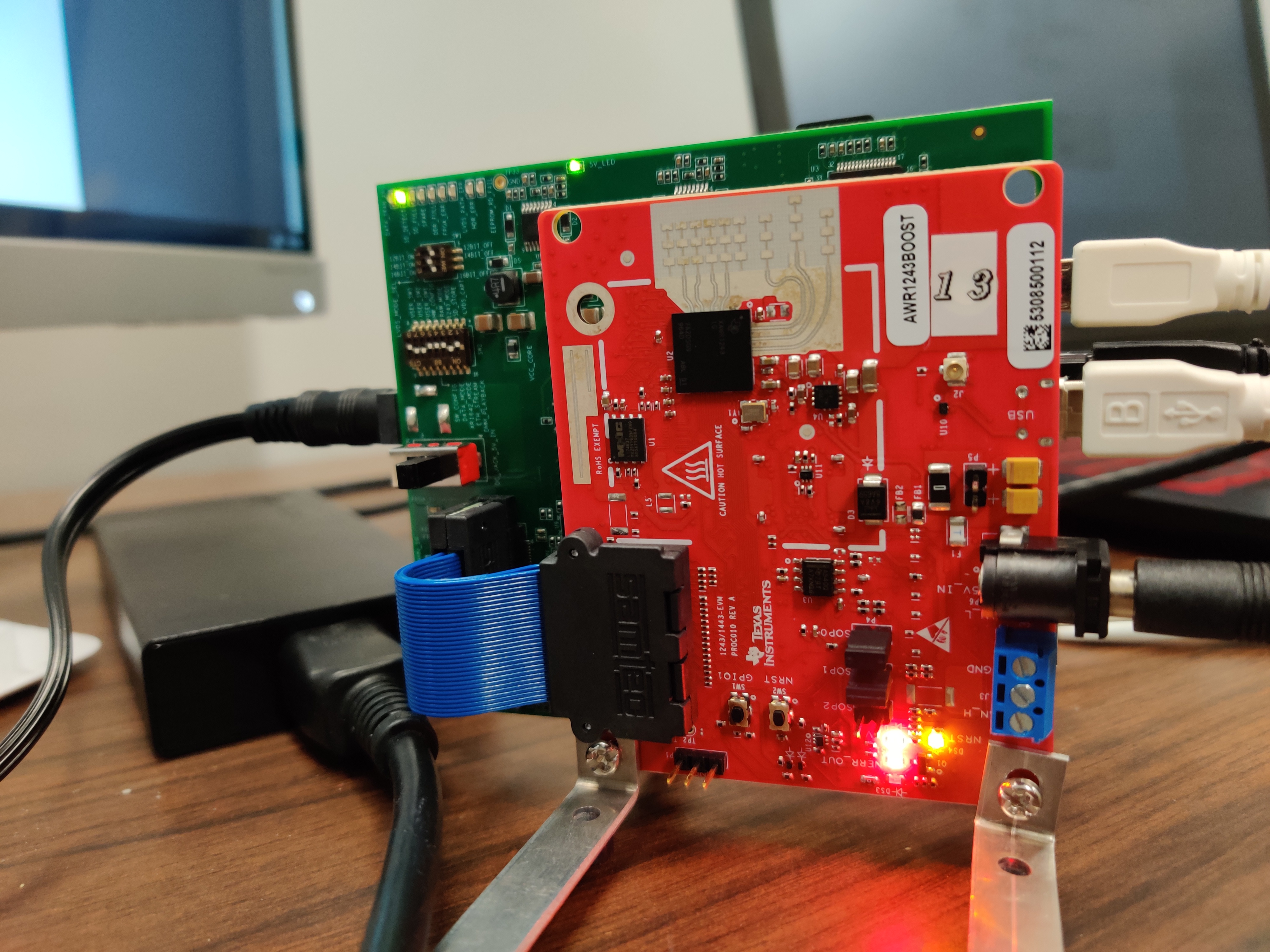

    Can you provide a complete picture(s) of your setup?
    Kyle
  • Hey Kyle,
    Oh sorry I should have specified for this log file that I was using the AWR1243BOOST board.
    Weilung

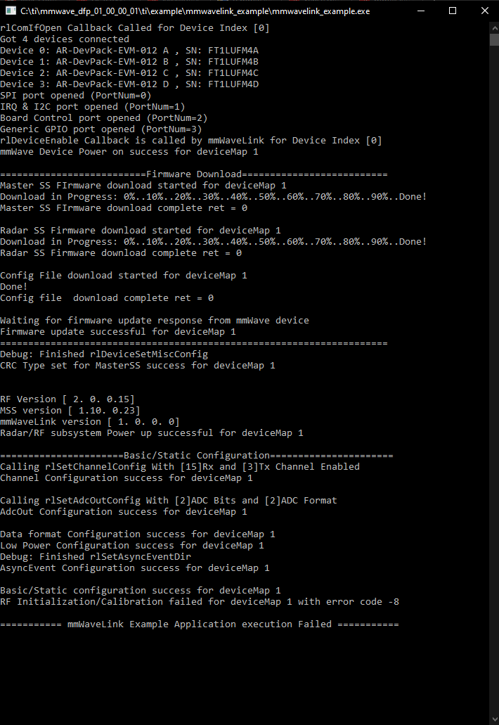

  • Okay so I used the firmware from mmWave studio v1.0 but it still times out.

  • Weilung,
    Can you upload a picture(s) of your physical setup?
    Kyle
  • Yeah here is a picture of my setup.
    Weilung
  • Weilung,
    Thank you for this picture. Can you upload a close up picture of the AWR1243 package? I need to be able to read the device markings.
    Kyle
  • Sure, here it is.
    Weilung
  • Hi Kyle,
    Is there any update on how I can resolve this issue with the DCA1000?
    Weilung
  • Weilung,
    A couple of things that I notice from your pictures.
    On the DCA1000, SW1 should be set where only "16BIT_ON" is set. It should be set as:
    - SW1.1 = OFF
    - SW1.2 = OFF
    - SW1.3 = ON
    For SW2, it should be set as:
    - SW2.1 = OFF
    - SW2.2 = ON
    - SW2.3 = OFF
    - SW2.4 = OFF
    - SW2.5 = ON
    - SW2.6 = ON
    - SW2.7 = OFF
    - SW2.8 = OFF
    These settings do not match the ones that you provided in your pictures and could be preventing proper functionality.

    Please upload a picture of what your Device Manager looks like when you have the AWR1243BOOST and DCA1000 connected. Make sure all six COM ports are populated.
    Kyle
  • I have inverted all the switches now and here is what my device manager looks like:
    But the other thing is, my device manager had all six COM ports populated before as well.
    Weilung
  • Weilung,
    Your picture did not upload correctly. Please try to upload it again.
    Kyle
  • Sorry I don't what happened.
  • Weilung,
    Try using the example program in DFP v1.0. See if you can get your AWR1243BOOST EVM working without the DCA1000.
    You can download the DFP here: http://software-dl.ti.com/ra-processors/esd/MMWAVE-DFP/01_00_00_01/index_FDS.html
    The example program is found here: C:\ti\mmwave_dfp_01_00_00_01\ti\example\mmwavelink_example
    Please read through the "readme.txt" first
    Kyle
  • Hi Kyle,
    I tried to run mmwavelink_example, but I got an application execution failed. Does that mean the AWR1242BOOST board is not working?
    Weilung
  • Weilung,
    Below is the log that I received when running this example on an AWR1243BOOST ES 2.0 EVM:

    Periodicity[100]ms
    Frame Configuration success for deviceMap 1
    Async event: Frame trigger
    Sensor Start successful for deviceMap 1
    Async event: Frame stopped
    Sensor Stop successful for deviceMap 1
    GPAdc measurement API success for deviceMap 1
    rlDeviceDisable Callback is called by mmWaveLink for Device Index [0]
    Device power off success for deviceMap 1
    =========== mmWaveLink Example Application execution Successful===========
    It looks like you may have an issue with your board. You may need to replace it.

  • What SOP pins do you have jumped for your AWR1243 board?
    Weilung
  • Hey Kyle,
    Just making sure, is the mmWave DevPack required to run this application?
    Weilung
  • Weilung,
    For this application, you need either a DevPack or a DCA1000EVM connected to your PC and the AWR1243BOOST. I configured the AWR1243BOOST so that only SOP0 was closed.
    Kyle
