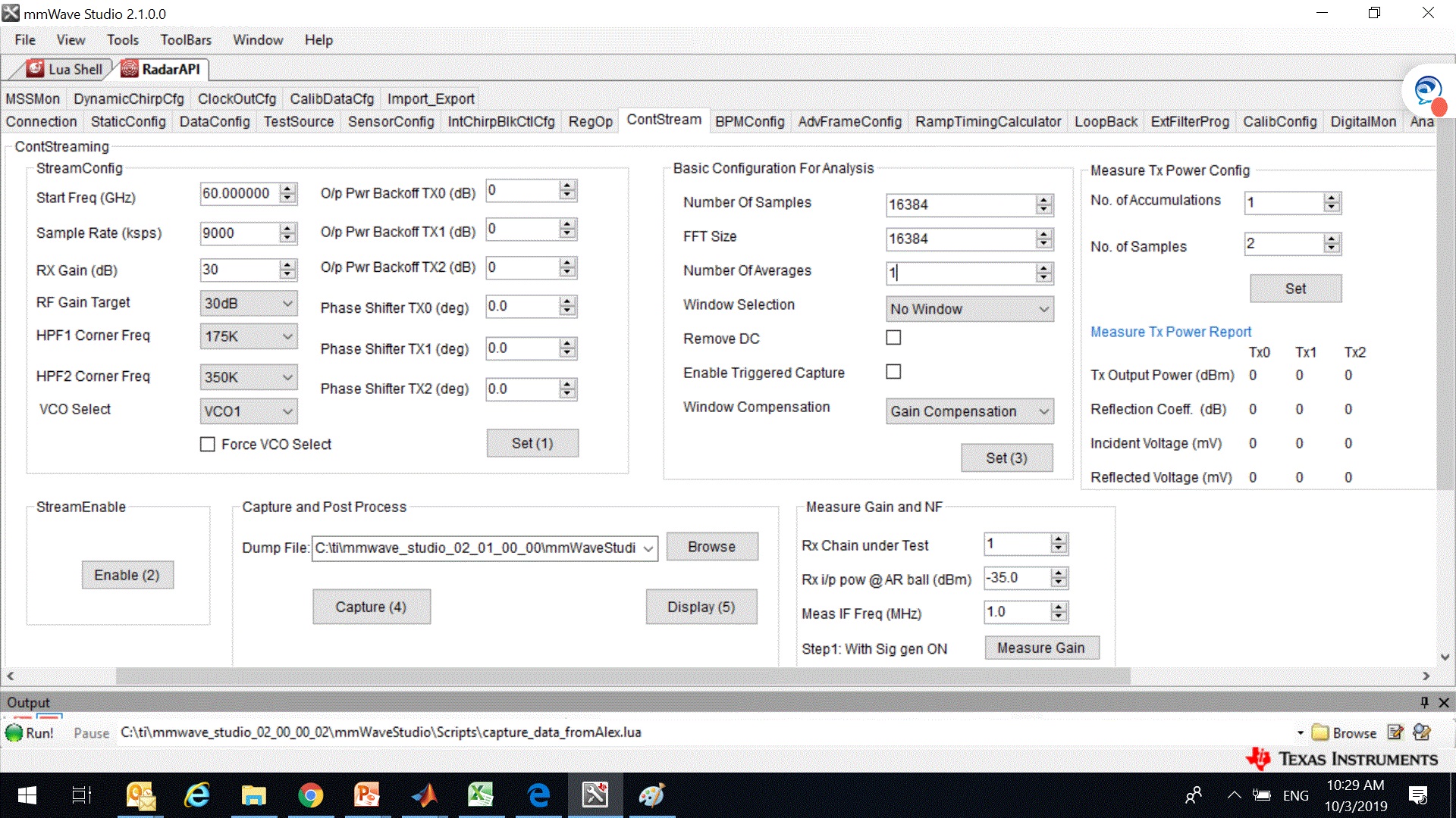

I would like to configure the IWR1642BOOST in Continuous Wave (CW) instead of FMCW and without using DCA1000EVM board.
I read in the mmWave Studio guide that it is possible to configure the sensor in CW mode.
My question is: is it possible to get the source code of this GUI to know how to setup the sensor to run in CW mode?
Thanks.
Best regards.

  • Hi, Anthony:
    The SDK processes the received signal in chirp and then in frames.  In your CW mode, are you still have this chirp and frame structure?   Then all of the signal processing will be different.   You will not be able to reuse much of the code in the SDK.    I do not see why you would like to devote a lot of code development time at this initial stage.  I suggest you to go through DCA1000 capture card.

    I was thinking of setting the chirps to be flat, I mean sizing the bandwidth to be equal to 0 (Stop frequency = Start frequency) in a very easy way  but it appears to be not possible: do you confirm?
    Concerning the DCA1000EVM, I do not see the relation in between this card and my initial request to set the sensor in CW mode: please could you clarify?

  • Hi, Anthony:
    SDK release does not support CW mode.    But radar studio support CW mode data capture through DCA1000 or TSW1400.  Use "ConstStream" tab below,
    Zigang
