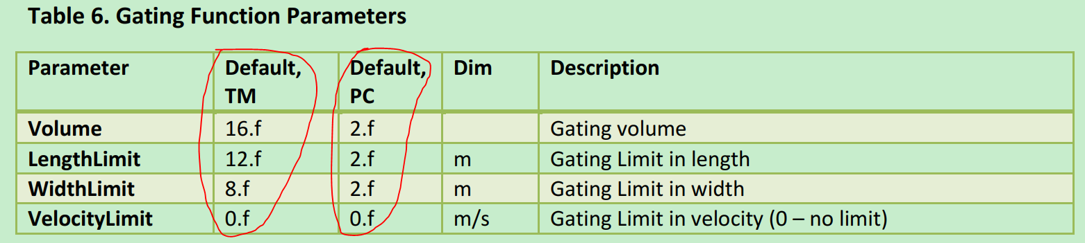

Gating parameter is to set the boundary for each tracked unit as per GTRack document (C:\ti\mmwave_industrial_toolbox_4_0_0\labs\traffic_monitoring\16xx_traffic_monitoring\src\mss\gtrack\docs\Tracking_radar_targets_with_multiple_reflection_points.pdf).
And in the GTrack document, there is a figure showing as below:
My question is: For the application of detecting both cars and pedestrians, could we find a good value of gatingParam for Gtrack detection of objects with wide dynamic range of size?
