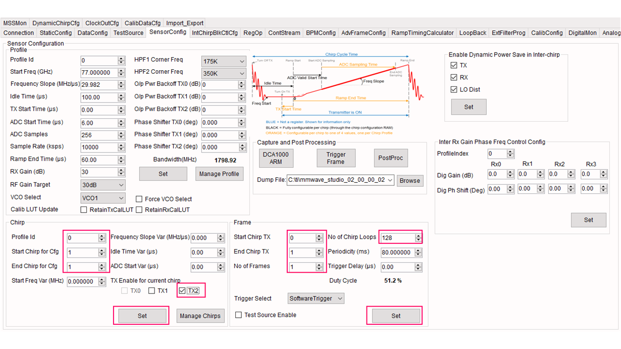

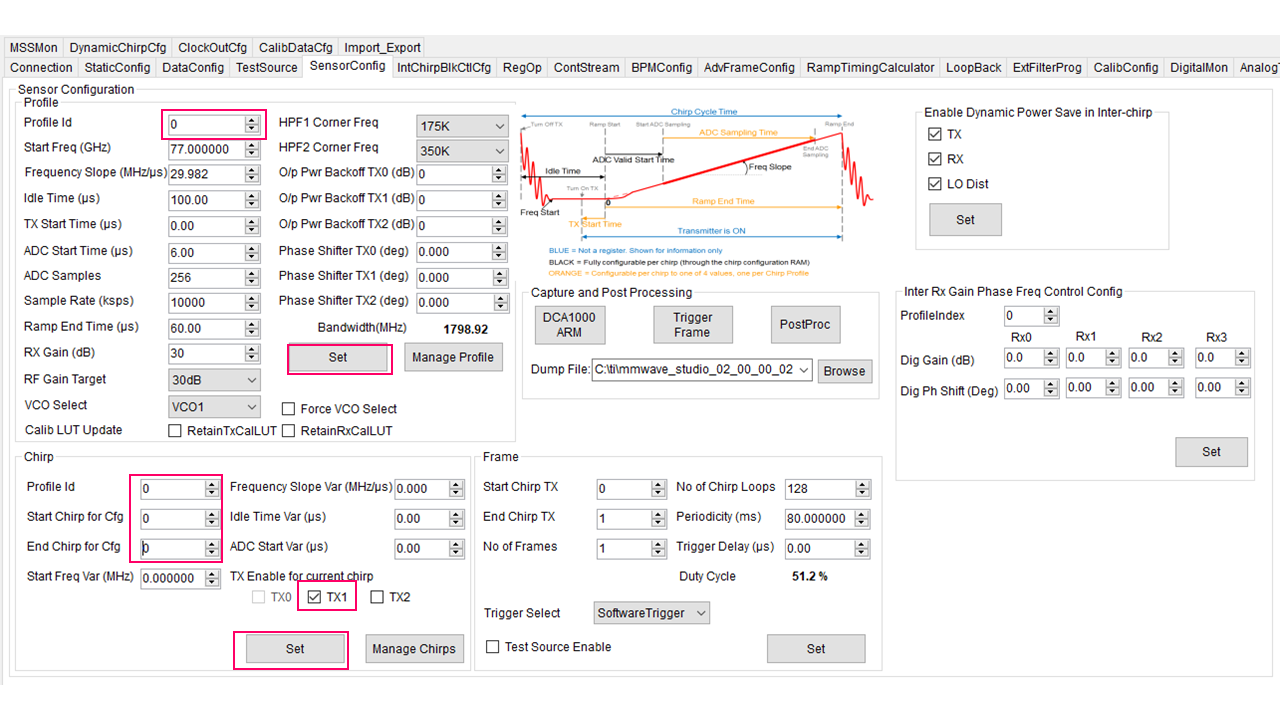

We are capturing data of Tx 2ch + Rx 4ch with AWR1243Boot + DCA1000EVM and trying to process the signal with Matlab.
We captured data with TDM MIMO (2 Tx + 4 Rx) with reference to the following QA thread.

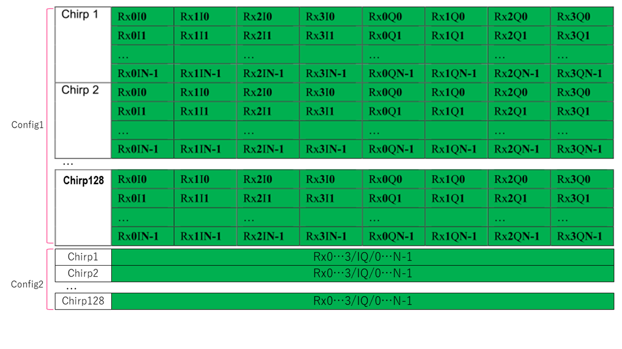

However, the data alignment of the saved binary file is unknown. Could you tell me the format rules?
Initially I thought it was the following data alignment, but when Config = 2 in the Post Proc of mmWave Studio, it did not match the result in Matlab.
mmwave_studio_user_guide.pdf has a description of the data format when captured by DCM1000EVM with one Chirp parameter, but there is no format description with multiple Chrip parameters.

    The profile and chirp of the SensorConfig tab were set to the following referring to the link.
    In addition, I set the Frame as follows.
    What pattern is the raw.bin data alignment that DCM1000EVM stores?
    We think following pattern.

    Are we misunderstood in the first place?

    The data format is described in the mmWave Studio User's Guide.
    Here is a small section of matlab code that we use to read raw data captured in MIMO for AWR1843.
    Thank you
    Cesar

    chunkSize = 2*Samples_Per_Chirp*Chirps_Per_Frame*numAnt;
    %% read binary file
    fname = strcat(DirName,fileName);
    fid = fopen(fname,'r');
    adcOut = [];
    inputLoadingPosition = 0;
    for indexFrames=1:numFrames
        fseek(fid, inputLoadingPosition, 'bof');
        dataChunk  = fread(fid, chunkSize,'uint16','l');
        inputLoadingPosition = ftell(fid);
        dataChunk = dataChunk - (dataChunk >= 2^15) * 2^16;
        % radar_data has data in the following format.
        % Rx0I0, Rx0I1, Rx0Q0, Rx0Q1, Rx0I2, Rx0I3, Rx0Q2, Rx0Q3, ...
        % The following script reshapes it into a 3-dimensional array.
        % size(adcOut) = [ADC samples per chirp x Chirps per Frame x Number of virtual Channels]
        len = length(dataChunk) / 2;
        adcOut(1:2:len) = dataChunk(1:4:end) + 1j*dataChunk(3:4:end);
        adcOut(2:2:len) = dataChunk(2:4:end) + 1j*dataChunk(4:4:end);
        adcOut = reshape(adcOut, Chirp_NUM_ADC_sample_size, numTXAnt*4, Chirp_NUM_Chirps);
        adcOut = permute(adcOut, [1, 3, 2]);
