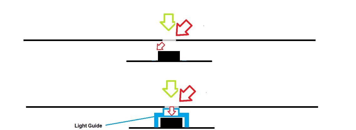

The customer has tested the sensors but isn’t happen in terms of incoming light.
If the light shines from perpendicular position, then it works ( green direction ) . But if light shines in from 45°, then the sensor doesn’t react ( red direction ). The customer stated that there will be most light coming from any angle, but mostly not from perpendicular direction.
