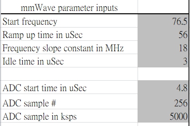

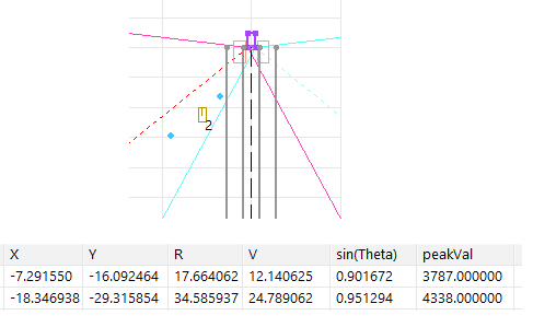

When we disable the Tx channel, we still receive the objects with velocity at Rx side(Test in the chamber).
The test result as follows:
For more information:
1. We use the low cost PMIC solution(LM53625 + LP87524J), and already bypass the internal LDO .
2. The start frequency is setting at 76.5GHz, so the VCO_SEL changed to 0(76-78 GHz).
Do you have any idea?
