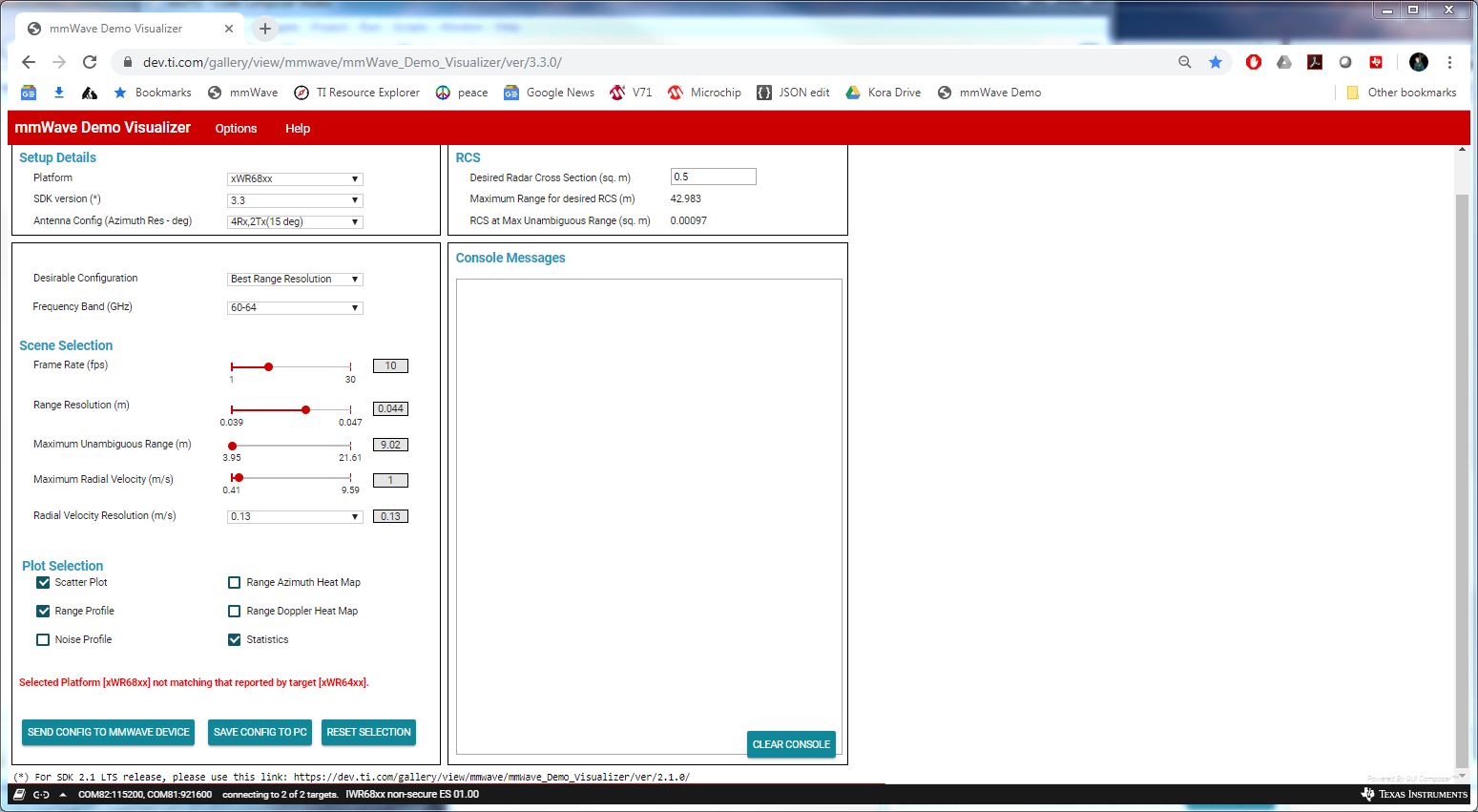

I then imported and built the project from lab 17 mmwave_sdk_68xx_hwa found in ti/mmwave_industrial_toolbox_3_6_2 that built ok and I used uniFlash to successfully load it on the board.  But when I connected
mmWaveDemoVisualizer version 3.30 it connected ok, but when I clicked on Send config to MMWAVE device, it gave me the error

    1. The 68xx - Out of Box demo labs (HWA as well as DSP versions) as well as many other labs in Industrial Toolbox are compatible only with IWR6843 ES2.0 device. This is mentioned in the corresponding lab user guides in toolbox 4.0.1.
    2. You can access previous versions compatible with ES1.0 using toolbox versions 3.6.2. The instructions to download a previous version of Industrial Toolbox are provided at the bottom of the Industrial Toolbox landing page as shown below:
    3. Project Import Error: Are you using CCS 9.x? If that's the case, you'll get the same error even with previous versions. This is a known incompatibility issue between CCS9.x and Projectspecs in Industrial Toolbox. Please use CCS 8.3.1 to import projects as listed in the lab user guide.
