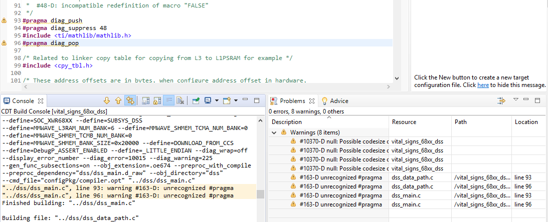

"../dss/dss_main.c", line 93: warning #163-D: unrecognized #pragma
"../dss/dss_main.c", line 96: warning #163-D: unrecognized #pragma

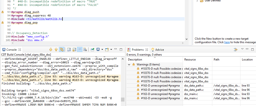

"../dss/dss_data_path.c", line 93: warning #163-D: unrecognized #pragma
"../dss/dss_data_path.c", line 96: warning #163-D: unrecognized #pragma

warning #10370-D: Possible codesize or performance degradation. Section ".text:MmwDemo_interFrameProcessing:dss_data_path.oe674" has calls to rts routines, but rts is placed out of range from call site at 0xe00a20, or in a different section. To optimize codesize, either 1) place rts closer to call site, or 2) place rts in same section, or 3) compile with --disable_push_pop.
warning #10370-D: Possible codesize or performance degradation. Section ".text:MmwDemo_interFrameProcessing:dss_data_path.oe674" has calls to rts routines, but rts is placed out of range from call site at 0xe02248, or in a different section. To optimize codesize, either 1) place rts closer to call site, or 2) place rts in same section, or 3) compile with --disable_push_pop.
warning #10370-D: Possible codesize or performance degradation. Section ".text:SOC_init:libsoc_xwr68xx.ae674<soc.oe674>" has calls to rts routines, but rts is placed out of range from call site at 0x20002910, or in a different section. To optimize codesize, either 1) place rts closer to call site, or 2) place rts in same section, or 3) compile with --disable_push_pop.
warning #10370-D: Possible codesize or performance degradation. Section ".text:SOC_init:libsoc_xwr68xx.ae674<soc.oe674>" has calls to rts routines, but rts is placed out of range from call site at 0x20002800, or in a different section. To optimize codesize, either 1) place rts closer to call site, or 2) place rts in same section, or 3) compile with --disable_push_pop.

So, I am wondering was my problem (can't run rebuilt demo) related to the warning during my rebuilt process? How may cause the issues mentioned in the warning messages? How can I rebuilt and run the demo successfully?

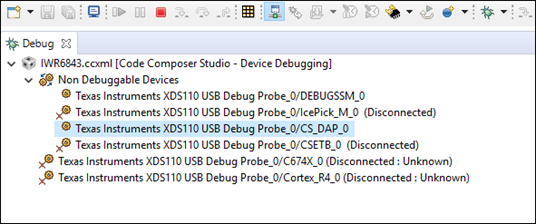

  • Hi Lola,
    Please flash the CCS debug firmware from SDK 3.1.1.2 and follow the procedure below to provide the requested register values. Thanks.
    1. Launch the CCS target configuration. Then right click on the configuration and select "Show all cores" as shown below:
    2. This will enable the "Non Debuggable devices" option. Select "Texas Instruments XDS110 USB Debug Probe_0/CS_DAP_0" option and press connect.
    3. With the CS_DAP_0 option connected and selected, Please enter the following expressions in the expressions view to read the corresponding register values:

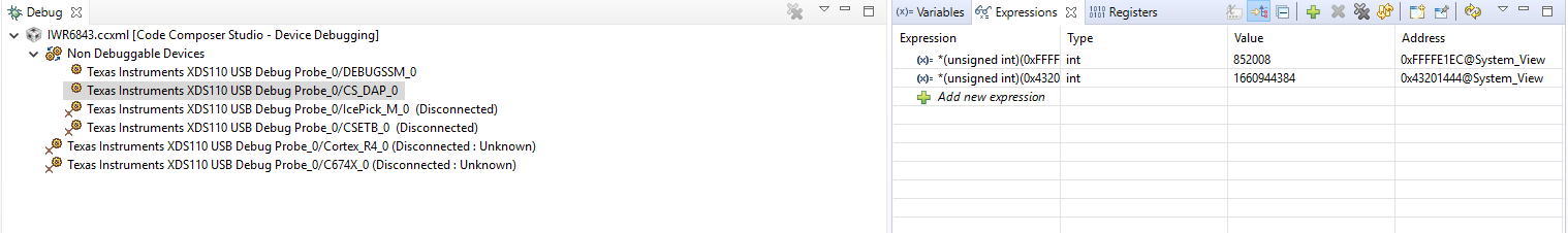

  • Hi Nitin,
    Thank you so much for the reply. Below is my results:
    Thank you and waiting for further instruction.
    Lola
  • I guess if I convert them to Hex, the first would be D0028(Hex) and the second one would be 63000000(Hex)
    Lola

  • Hi Lola,
    Thanks for your patience and providing the requested debug information. The values you provided indicate that the IWR6843 ES 1.0 device on your IWR684ISK has an irrecoverable failure during boot-up and needs to be replaced. We have identified that this issues affects some IWR6843 ES1.0 devices and this has been resolved in ES2.0 devices.
    Please contact your local TI sales representative to request a replacement ISK.
    -Nitin
