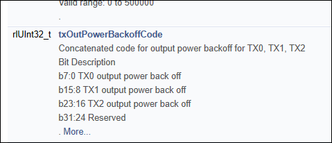

Since SPEC limits the EIRP to 10dBm only, if the IWR6843 transmits 3 TX simultaneously with each 10dBm, then its EIRP will be (10dBm + 4.7dB for 3 TX + 9dBi for antenna gain == 23.7 dBm), which over the SPEC.
Is this correct?
Then how could I reach the maximum performance for TX power?
