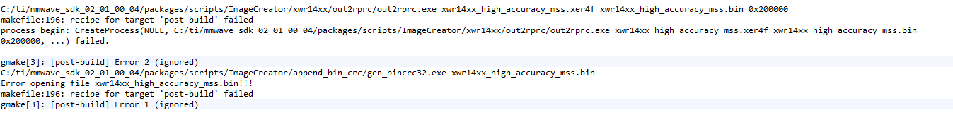

Bin files seems to be not created with the following errors while building.

Hi Divya,
From your log, I understand that you are trying to build the 14xx- High Accuracy Lab with SDK 2.1.0.4. As noted in the release notes for this lab, this lab supports SDK 1.2.0.x and has not been updated for SDK 2.1.0.4. We will update this lab to SDK 2.1.0.4 in a future release. However, if you wish to do it yourself in the meantime, you can port it to SDK 2.1.0.4 (for IWR1443 ES3.0) using the instructions provided in the following post:
RTOS/AWR1443: Vital Signs: SDK migration 1.2 to SDK 2.1
-Nitin
