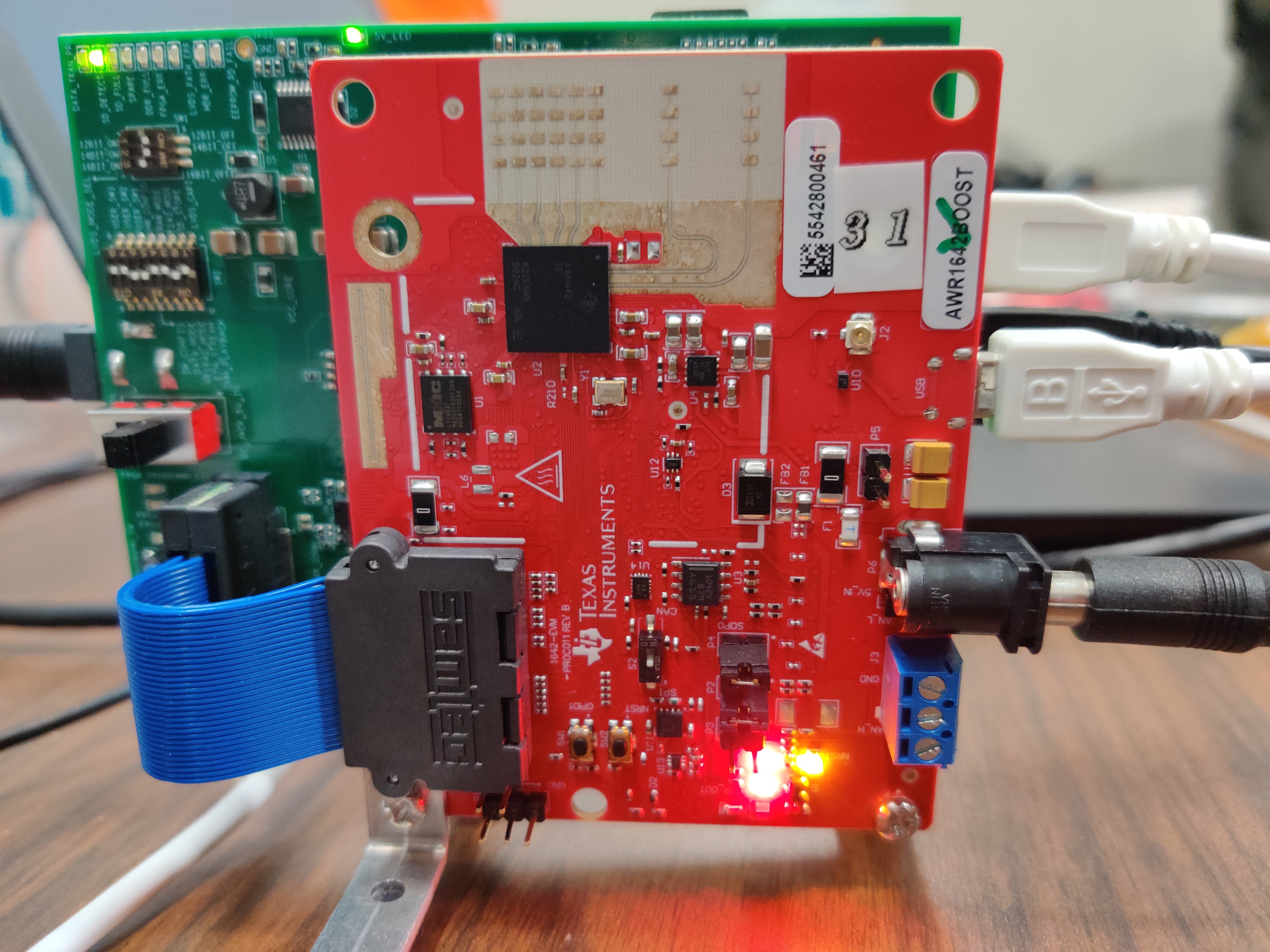

Hi, I am having trouble getting the data config tag to connect on the DCA1000 with the AWR1642BOOST. This is my output file from trying to set the RadarAPI.
GM: Constructor

[15:08:33]  Status: Failed, Error Type: RESP TIMEOUT
[15:17:40]  [RadarAPI]: ar1.LvdsClkConfig(1, 1)
[15:17:43]  Status: Failed, Error Type: RESP TIMEOUT
[15:17:44]  [RadarAPI]: ar1.LVDSLaneConfig(0, 1, 1, 0, 0, 1, 0, 0)
[15:17:47]  Status: Failed, Error Type: RESP TIMEOUT
Weilung
    It looks like RS232 is not connected.
    Please make sure you are selecting the correct COM port. Try a different USB cable
    For the next step (SPI connection)
    Please make sure that S2 switch selects SPI interface
    See Section 2.7.4 Selection Between SPI and CAN Interface
    Thank you
    Cesar
    I changed the cables and checked the switch to make sure it was on SPI and it is but I am still getting the same errors and the RS232 is still not connected.

    Weilung
  • Okay I think I got the RS232 to connect now but the RfInit times out.

  • Weilung,
    It looks like you are not loading the correct firmware images to your device. You have an AWR1642BOOST EVM that is an ES 2.0 device. You are attempting to load firmware for an ES 1.0 device. Please update to use the correct firmware image.

  • Hi Kyle,
    I changed it to the ES2.0 firmware but I'm getting an error on the static config.

    Weilung
  • Weilung,
    Please read through the log file that mmWave Studio provides. The log clearly states that:
    "Status: Failed, Error Type: REGULAR ADC MODE NOT SUPPORTED IN 5 MHz PART VARIANT DEVICE"
    That means you need to enable low power mode for the ADC on AWR1642. This is the reason you are getting a timeout.
    Kyle
  • Okay I have changed it to low power mode, now the RfInit times out.

    Please upload a picture of your physical setup.
    Kyle
  • Hey Kyle.
    Okay here is a picture of my setup.
    Weilung
