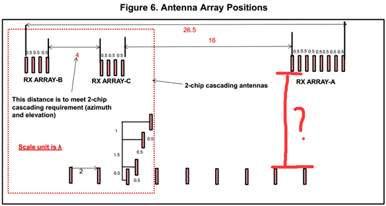

Customer would like to know what is the relative distance between the transmit antenna TXS and the receive antenna RX on the TIDEP-01012 cascaded RF board?

Hi Annie,
The MMWCAS-RF-EVM user guide and layout files should be referenced for those kinds of questions. All of that is available on the MMWCAS-RF-EVM tools page: https://www.ti.com/tool/MMWCAS-RF-EVM
The user guide (https://www.ti.com/lit/ug/swru553/swru553.pdf), page 25, Figure 16 describes the TX to RX array horizontal and vertical offset from each other. You can reference the layout files (https://www.ti.com/lit/zip/tidrzz6 ) for any specific dimension you want. I called out the distance from the top of the RX array element to the bottom of the TX array element as dimension B1 = 2928.84 mils (74.392 mm).
Please let me know if that solves your problem.
