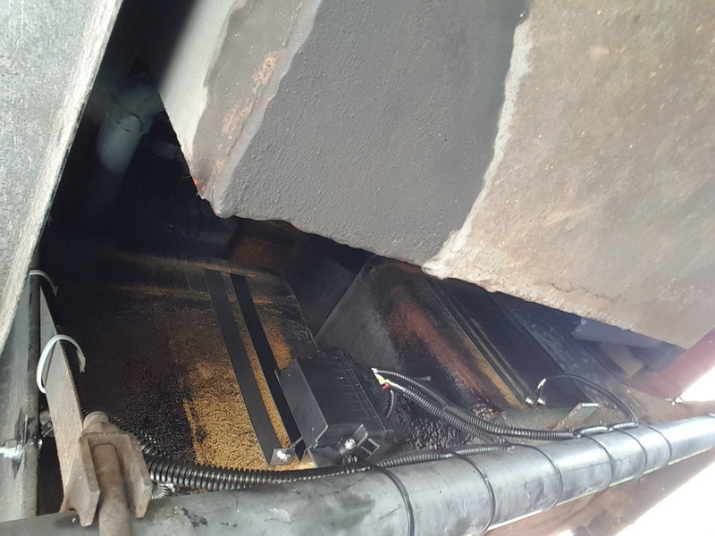

Here's a photo showing the setup.  The black plastic enclosure has the FDC in it.  You can see all 4 electrodes here.  They are 1" wide and about 13" long spaced 0.5" apart.  The tank on the left is full of water.  The capacitance of the righthand tank did not change while I was filling the left tank.  When I started to fill the righthand tank its value changes as expected, but the lefthand tank started to offset by almost the exact same amount!

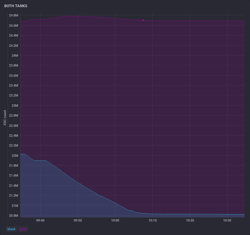

Here is a graph comparing the two tanks' raw FDC output values.  The left tank on the graph is the left tank in the photo above.  The steps in the graph are where I stopped filling the righthand tank!

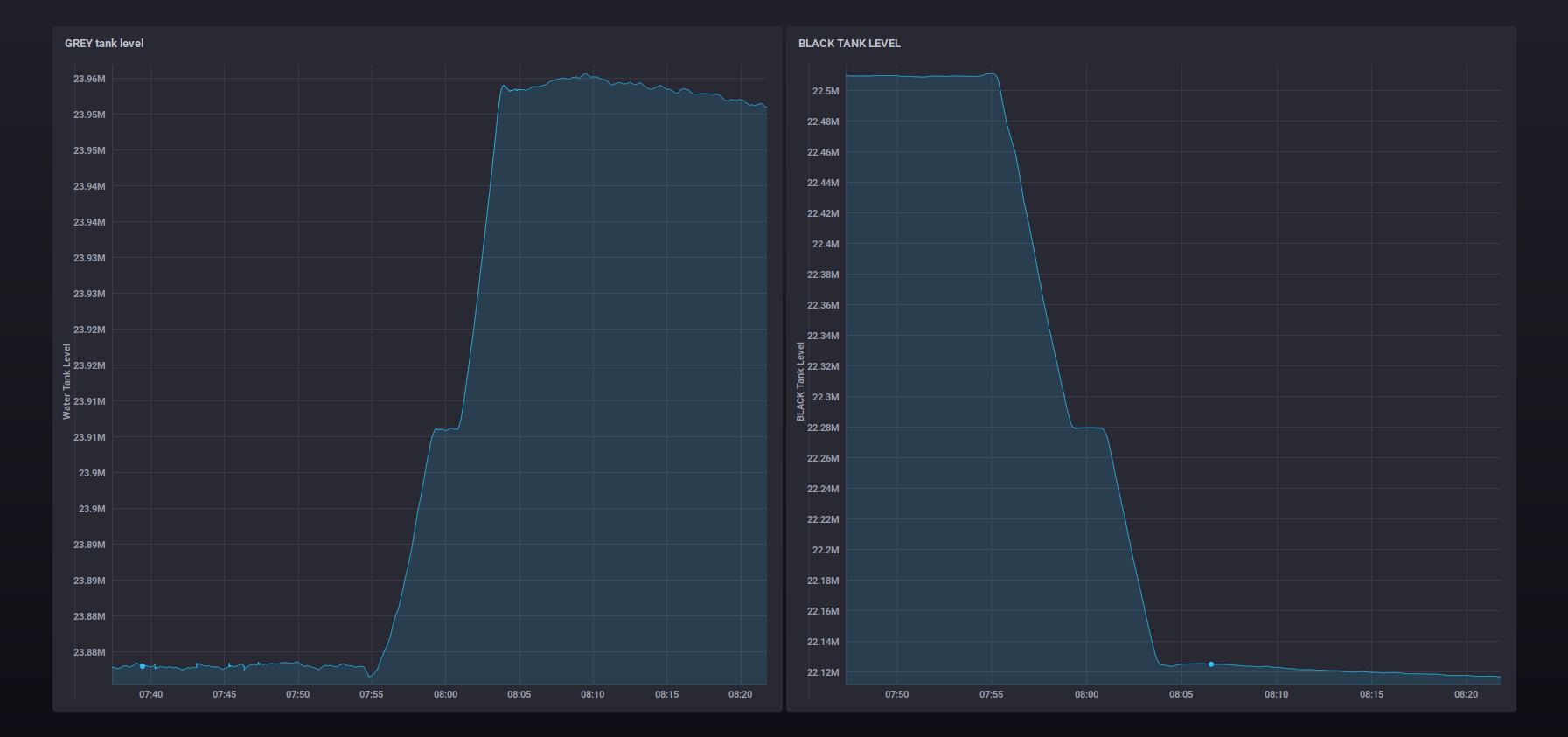

  • I did some more testing.  I went ahead and just completely filled up the other tank (right hand side) and it looks like I got a "bump" on the left side, so it went up a bit and came back down.  I might have some interaction between the tanks I guess.  Does grounding the liquid inside the tanks have any benefit in all of this?  I can probably deal with this, but I'd rather find a reasonable way around it.
    Here's the chart showing the two tanks in action.  The upper line represents the left tank from my previous post, you can see the bump while the other tank is shown filling below it.

    Thanks for your patience while I was out of office. Based on the size of your sensors, it's not surprising that the liquid level in the second tank is affecting the measurement of the first sensor. These sensors will have a very large sensing range (potentially ~20 inches, based on figure 3 in our capacitive proximity sensing app note). It's very possible that the second tank is within the sensing range of the first sensor.
    I don't believe that there's a specific setting that's causing this, but I do recommend verifying that the sensor oscillation amplitude is within the optimal range (1.2-1.8V). You can probe INxA or INxB vs the FDC's GND to make sure this is the case.
    I don't think it would help to ground the liquid. Additionally I think this behavior has more to do with the size of the sensors and their proximity to the tanks than it has to do with both sensors being connected to the same FDC2214. It's better to use a single FDC2214 for this setup, because then the sensors will definitely not make measurements at the same time and potentially interfere with one another.
