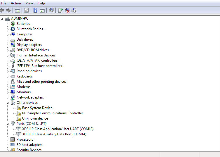

I have flashed out of box demo in AWR1843 EVM.i was trying to connect the data port and user port to PC using teraterm but could not achieve it.
while i can able to debug the code using CCS and even i tried to connect with demo visualizer it didn't.

  • Hi Jitendra,
    after restarting system i can able to open the COM port.
    But the issue is, when the device is in debug session in CCS ,i plugged out the USB cable, after that if i plug in i cannot able to connect to COM port.
    what do i need to do to connect the COM port and i do not want to restart my system.
    Even i tried changing COM port number manually in device manager but still i face the same issue.i checked with demo visualizer also it says serial port already opened.
    some of my applications is being connected to the COM port even i closed all the applications

    now i restarted my system,i tried flashing in uniflash in the flash mode,i can flash the image.
    then i closed the uniflash application and changed to functional mode and restarted the device and tried to connect to demo visualizer and teraterm ,it couldn't connect.
    but i can able debug my code in CCS .after debugging in CCS ,now i couldn't connect with uniflash also.still wondering what was is the problem.

    I know that i cannot connect Visualizer and TeraTerm at the same time.
    i can able to flash the binary to the device using uniflash,i can connect to teraterm and i can connect visualizer, But
     after some time i cannot connect to anything either uniflash,teraterm or visualizer.i need to restart my system again to connect to com port.some application is getting connected with the COM port.
    the reason i'm using teraterm with mmwdemo is to see the data what exactly it is sending and once i figure out the data,i will be sending data over CANFD ,thats my thing as of now.
