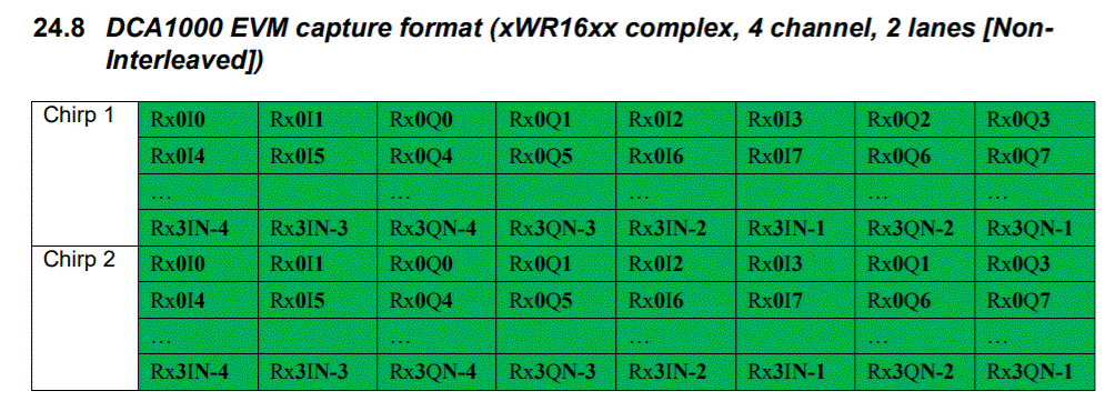

  • Hi, Harold:
    If you download the radar studio, you can find the raw data format in section 24.8 (DCA1000 EVM capture format (xWR16xx complex, 4 channel, 2 lanes).   You can load the binary data and process it based on the format.
    C:\ti\mmwave_studio_02_01_00_00\docs\mmwave_studio_user_guide.pdf
    Note that the data format for xWR16xx, xWR18xx, xWR68xx are all the same.
    Zigang

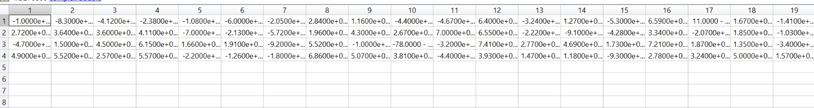

  • Hello Zigang,
    I have been able to extract binary data but i do not understand the information being shown.
    I am unable to process this data.
  • HI,
    Here attached the format for the binary data.
    And here is an example MATLAB script on how to process one frame of ADC data from binary file.  And at the end, the adcOut matrix is 3 dimension array, with first array is ADC samples, second dimension is for different chirp, the third dimension is for different TX-RX antenna pair.
    fid = fopen(fname,'r');
    dataChunk = fread(fid,numSamplesPerFrame*2,'uint16','l');
    fclose(fid);
    dataChunk = dataChunk - (dataChunk >= 2^15) * 2^16;
    % radar_data has data in the following format.
    % Rx0I0, Rx0I1, Rx0Q0, Rx0Q1, Rx0I2, Rx0I3, Rx0Q2, Rx0Q3, ...
    % The following script reshapes it into a 3-dimensional array.
    len = length(dataChunk) / 2;
    adcOut(1:2:len) = dataChunk(1:4:end) + 1j*dataChunk(3:4:end);
    adcOut(2:2:len) = dataChunk(2:4:end) + 1j*dataChunk(4:4:end);
    %clear dataChunk
    adcOut = reshape(adcOut, Chirp_NUM_ADC_sample_size, numTXAnt*4, Chirp_NUM_Chirps);
    adcOut = permute(adcOut, [1, 3, 2]);
    Zigang
