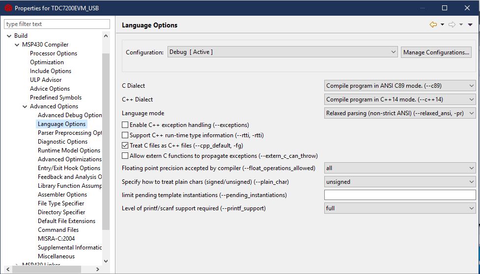

    I installed the Code Composer Studio (CCS) V9, Compiler TI v18.12.3LTS and imported the CCS project(TDC7200EVM_USB).
    I had several compiler errors and fixed it with following compiler flags:
    -vmspx --data_model=restricted --use_hw_mpy=F5 --include_path="${CCS_BASE_ROOT}/msp430/include" --include_path="${CG_TOOL_ROOT}/include" --include_path="${PROJECT_LOC}/../../code/F5xx_F6xx_Core_Lib" --include_path="${PROJECT_LOC}/../../code/include" --include_path="${PROJECT_LOC}/../../code/driverlib/MSP430F5xx_6xx" --include_path="${PROJECT_LOC}/../../code/driverlib/MSP430F5xx_6xx/deprecated" --include_path="${PROJECT_LOC}/../../code/USB_API/USB_Common" --include_path="${PROJECT_LOC}/../../code/USB_config" --include_path="${PROJECT_LOC}/../../code/USB_app" --include_path="${PROJECT_LOC}/../../code" --include_path="${CG_TOOL_ROOT}/include/libcxx" --advice:power=all --define=__MSP430F5529__ -g --cpp_default --printf_support=full --diag_warning=225 --diag_wrap=off --display_error_number --abi=eabi --silicon_errata=CPU21 --silicon_errata=CPU22 --silicon_errata=CPU23 --silicon_errata=CPU4
    Then I changed the "Language Options" to solve the "_LIBCPP_BEGIN_NAMESPACE_STD" and "printf_support mode" error.
    After that:
    1. change host_interface.c
      1. delete: "extern uint8_t USB_disable(void);"
      2. add: #include "usb.h"
    2. Delete or exclude from Build: "USB_API/msp430USB.Id"
    Now everything works well.
