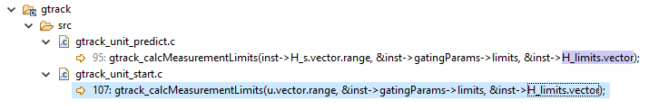

At the same time, for the limit parameters, i.e. DepthLimit, WidthLimit, HeightLimit and VelocotyLimit, in the 'Gating Function Parameters', they are updated into 'H_limites.vector' as below.
But the H_limits.vector hasn't been used in any other places. So it seems like the limit parameters are dummies.

    First, Volume has been replaced with what is referred to internally as "Gain".  GTrack calculates dimensions for the gating function. Each dimension can be grown by the Gain amount, but ultimately limited by the limit.  Growth is multiplicative. So if the Gain is 3, and the dimension is 2, with limit 4, then it could grow up to 3*2 = 6, but will be limited to 4.
    I will check with the author to determine if the limits are used.
