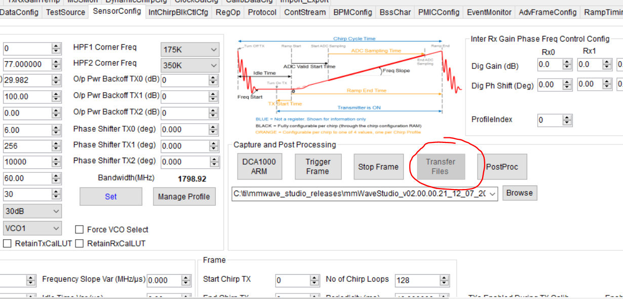

    The TDA2x captures data to an onboard NVME SSD. This is the SSD mounted to /mnt/ssd in the linux file system that we discussed earlier. The "capture_directory" variable is meant to simply create a new directory on that SSD for the next capture files to be stored into. For example setting
    capture_directory               =   "capture_test1"
    would create the   /mnt/ssd/capture_test1/ on the SSD and then the subsequently triggered capture would store that data into it.
    After the capture is completed, users can use the "transfer files" button (see below) in the SensorConfig tab to transfer the files over to the connected host PC. These files are transferred over to the "C:\\ti\\mmwave_studio_02_01_00_00\\mmWaveStudio\\PostProc\\" directory you were referencing. But there is no user configuration for determining where the transferred files will be stored.
