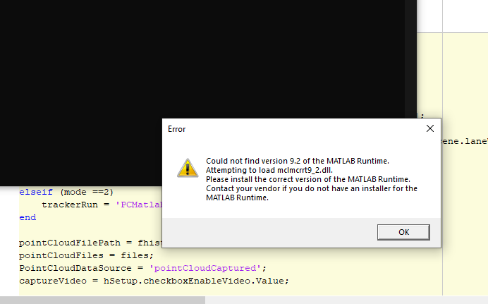

so when i try to run the example code given from matlab for the traffic monitoring sensor i am getting errors  have not modified it
  • also when i try to open a .exe file i get the following error
    do the 2.0 version for the ccs traffic monitoring example code require a older version of matlab to run?

    Please follow the user’s guide and install the runtime version exactly as specified. 9.2a is required to run the pre-compiled  .exe.
    When you are running from source code are you providing all the setup inputs as described in the user’s guide? The error suggest that you are not selecting a valid CFG file in the setup window.
