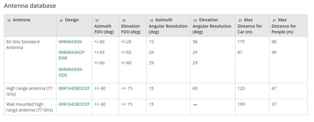

In addition, I would like to know if the IWR6843ISK-ODS can achieve the same effect as the official demo video (IWR1443 in the video ).It seems that the angular resolution of the IWR6843 is not very high.
