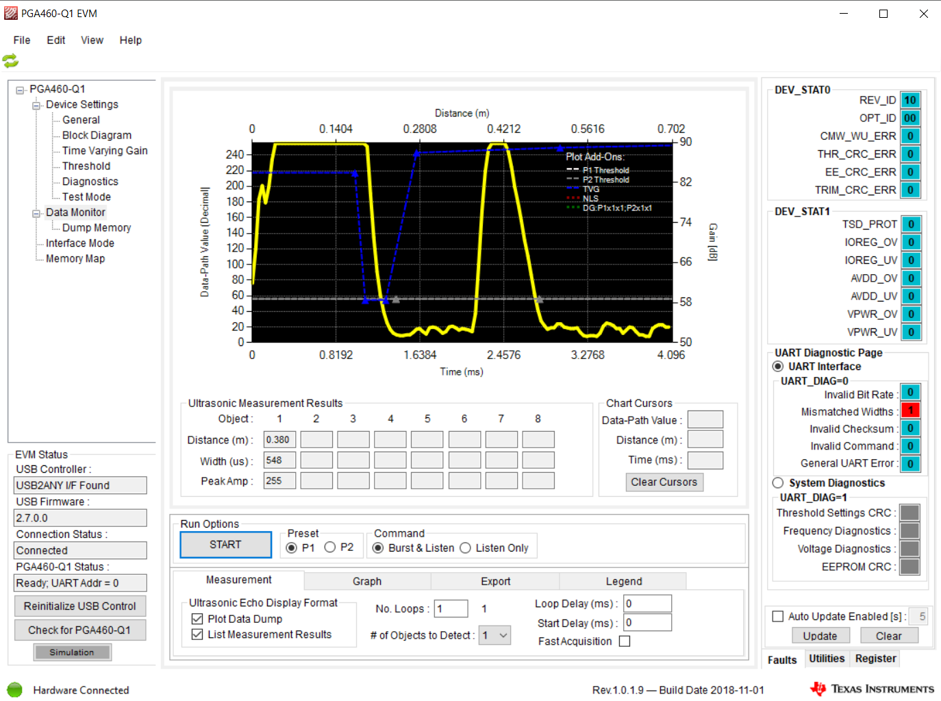

First, here's what the Data Monitor in the GUI gives me for my small object at an easy position to detect:
Unit 0 Object at Midpoint
As you can see, I can get a very consistent 0.380-0.381m distance value. The noise floor is sufficiently below the constant threshold line that I never get a false positive when my object is at that position. Everything is perfect for what I need.
Next, I wanted to make sure I put the values used in the GUI into Energia, through PGA460_USSC.cpp. I read the values from the memory map in the GUI (attached below), then used those values in presets in the .cpp file. I changed case 0 of the .cpp file for threshold and TVG to make things easy.

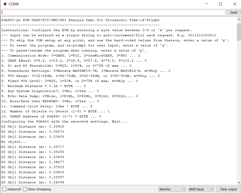

For the prompts:
I am using OWU and so prompt 1 is 2.
Prompt 2 is 9.6kbaud to match the serial monitor.
Prompt 3 is 0 to use the Threshold preset I showed above.
I skip prompt 4 since I prefer to use my own settings set in the GUI (currently 58.8kHz, 5 pulses, 500mA). Are these values not being used by Energia? I'm just trying to think where things might go wrong, and I know all 3 of these values get reset when I re-flash the board in the GUI.
For prompt 5, I use 3 since that is the same range displayed in the GUI.
Prompt 6, I do the same as for the threshold values and choose preset 0. Below is the rewritten preset 0:
//Set fixed AFE gain value
	switch (tvg)
		case 0:  //CUSTOM FROM GUI	 OLD:25% Level
		   TVGAIN0 = 0x60;
		   TVGAIN1 = 0x12;
		   TVGAIN2 = 0x8A;
		   TVGAIN3 = 0x00;
		   TVGAIN4 = 0x0E;
		   TVGAIN5 = 0xFD;
		   TVGAIN6 = 0xFC;
		break;
For prompt 7, I choose 2 just to avoid the transmission burst giving me a false positive.
Prompt 8 is 0.
Prompt 9 is 0.
Prompt 10 is 0.
Prompt 11 is 5 for some arbitrary delay.
Prompt 12 is 1.
Prompt 13 is 0.
I then receive these very strange distance values in the serial monitor. The object and transducer/board have not been moved at all.
Getdistance Output at Midpoint
Any idea why P1 is not displaying anything, and P2 is giving varying distances?
The code shows that P1 is used first, then P2 is run if nothing is detected. However, both of my threshold presets use the exact same values now (copied from the GUI). Or am I misunderstanding what P1 and P2 mean here? Are P1 and P2 not the threshold presets? Are some other values than just threshold values being changed depending on which preset is used? If that is the case, how can I go about matching what the GUI does?
My goal is simply to replicate what I get through the GUI (hopefully soon on 4 boards using BusDemo). Again, I copied the GUI threshold values to both P1 and P2 of preset 0, since those are the only values I will need for now (constant 56).
Are the threshold/gain values I input not being used? Is the 58.8kHz, 5 pulse count, and 500mA from the GUI not being used? Any other ideas?

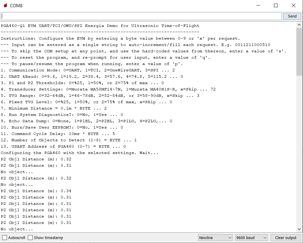

  • Some information from any additional tests I could think to run:
    I replaced the muRata MA58MF14-7N values in the .cpp file with the values from the GUI memory map for my unit 0 above. I have noticed that even though the distances reported are still not as consistent as with the GUI, they are still slightly better than before. They don't vary quite as much, and I have fewer "no object..." messages. Here is a copy of the new serial monitor output. As you can see, I chose option 0 for prompt 4 to use those GUI memory map values. Also, I edited the number of values shown for more precision. Nothing else was changed.
    Using Custom Transducer Settings
    I also ran an EDD from GetDistance for P1BL and then P2BL, and compared the curve to one from the GUI. All 3 were almost identical. I forgot to save the two comparison pictures, however, so I won't have those to show unless you ask me to repeat it. In any case, just like the same problem months ago, it seems the problem is with Energia not using my GUI settings somewhere.

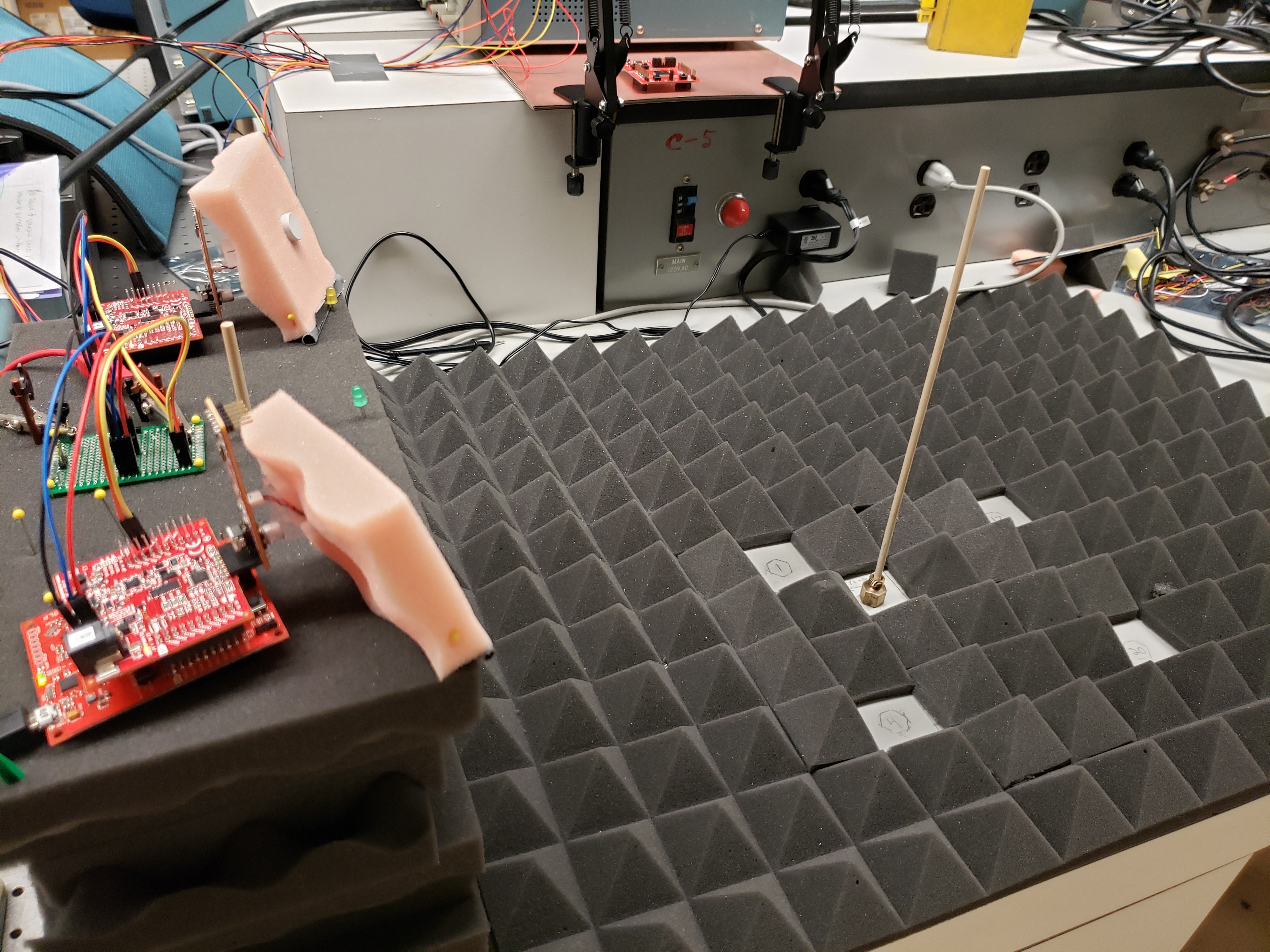

    Here's some additional info that may or may not help:
    I tested 20 points in a 15x20cm grid and found that the difference between physically-measured and Energia-reported distances (from BusDemo) is somewhat constant over all the points for an individual board, but not across boards, even though both boards are almost exactly the same distance from the test grid (reference photo shown below).
    physical setup for reference
    Board 0 (closest in photo) gives a required offset that's between +0.04m and 0.055m depending on the point, and board 1's offset is between +0.018m and 0.035m.
    And again, in the GUI both boards give roughly the expected distance values regardless of the point.
    I know these boards weren't exactly intended to be used for such a small-scale application, but I'm hoping I can get this working for my current setup.
    Ideally I'd be able to get the Energia distances reported to be as accurate as from the GUI without having to do the manual offsets in the sketch for each point, which I am currently doing, so that it could be used outside this exact grid or between points on the grid as well.
    If you have any other suggestions that might help with that, I really appreciate it.
