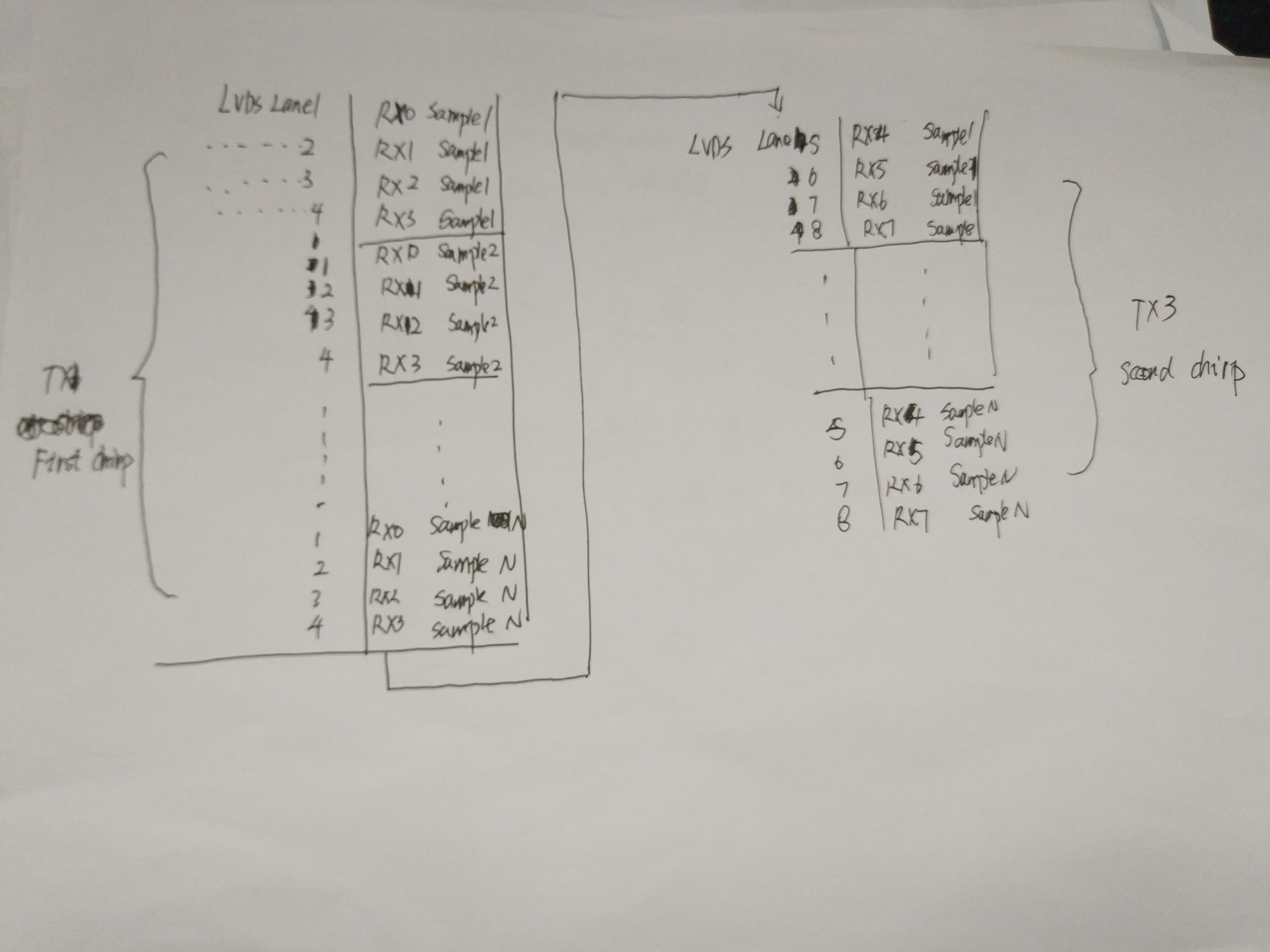

I am currently studying the MIMO mode of the AWR1443, and I noticed that the device can be set to TDM-MIMO and BPM-MIMO mode. So I configured the AWR1443 into TDM-MIMO mode according to the configuration requirements shown in Figure 1.
                                                                                                                                                      Fig.1
I analyzed the data after I got the data. I have some doubts about the data format in TDM-MIMO mode. I analyzed the data after I got the data. I have some doubts about the data format in TDM-MIMO mode.
                                                                                             Fig.2
                                                                                                                                      Fig.3
That is, only when the device starts running in TDM-MIMO mode, only when the first antenna first acquires a chirp, the second antenna acquires the next chirp and then alternately collects all the data. Please tell me if I understand the data format in TDM mode correctly. At the same time, if your company has a data format document or picture description in MIMO mode, it is better. Thanks!
Sleepybear
    Based on your snapshot it looks like you are using LVDS transfer using the DCA1000 capture board.
    Please check the section "23.6 DCA1000 EVM capture format (xWR12xx/xWR14xx complex, 4 channel, 4 23.6lanes [Interleaved])"
