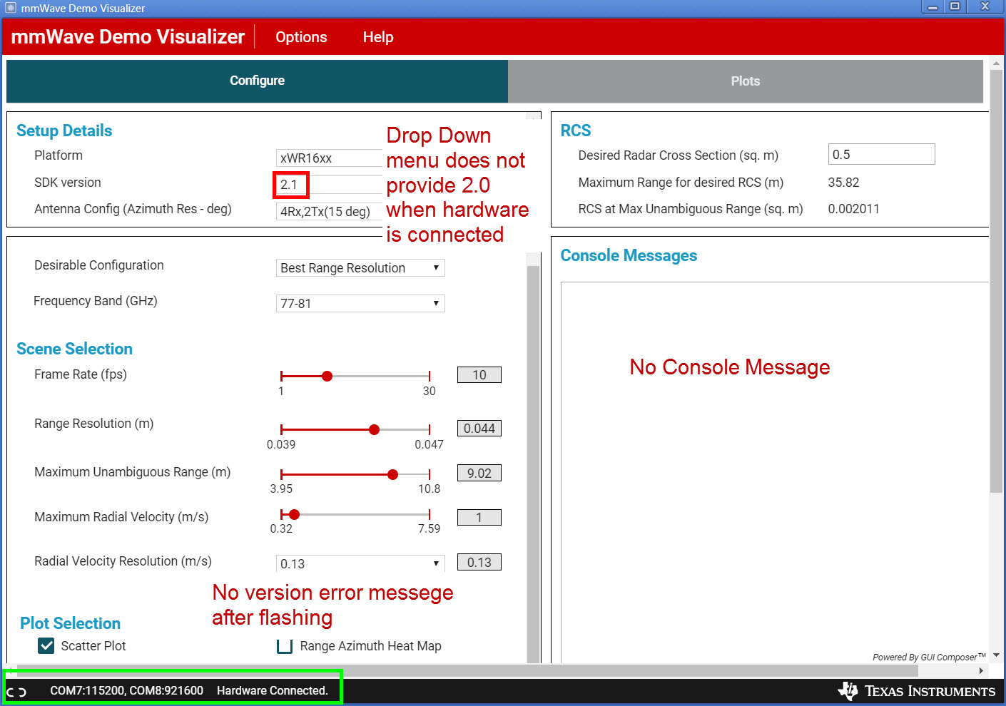

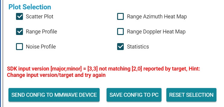

Hi, My company purchased "AWR1642BOOST-ODS" in September 2019 but we received the hardware with old SDK v2.0. We started with latest SDK v3.3 and mmwave visualization Demo v3.3. There was an error saying hardware needs SDK 2.0 after harware ports were connected. Then I used old mmWave Demo visualizer for v2.0 and oldest available SDK 2.1 (mmwave_sdk_02_01_00_04) that initially resulted in the same error. The error disappeared after flashing with  Uniflash v5.1.0 using "C:\ti\mmwave_sdk_02_01_00_04\packages\ti\demo\xwr16xx\mmw" binary, but there is no console message when "Send Config to mmwave Device" is clicked. I have already requested for SDK 2.0 but my request is pending export control approval. What should be my next course of action? Is there a way to update firmware of the device? Please refer attached images: Issue with version
Issue after flashing the device and using SDK v2.1
