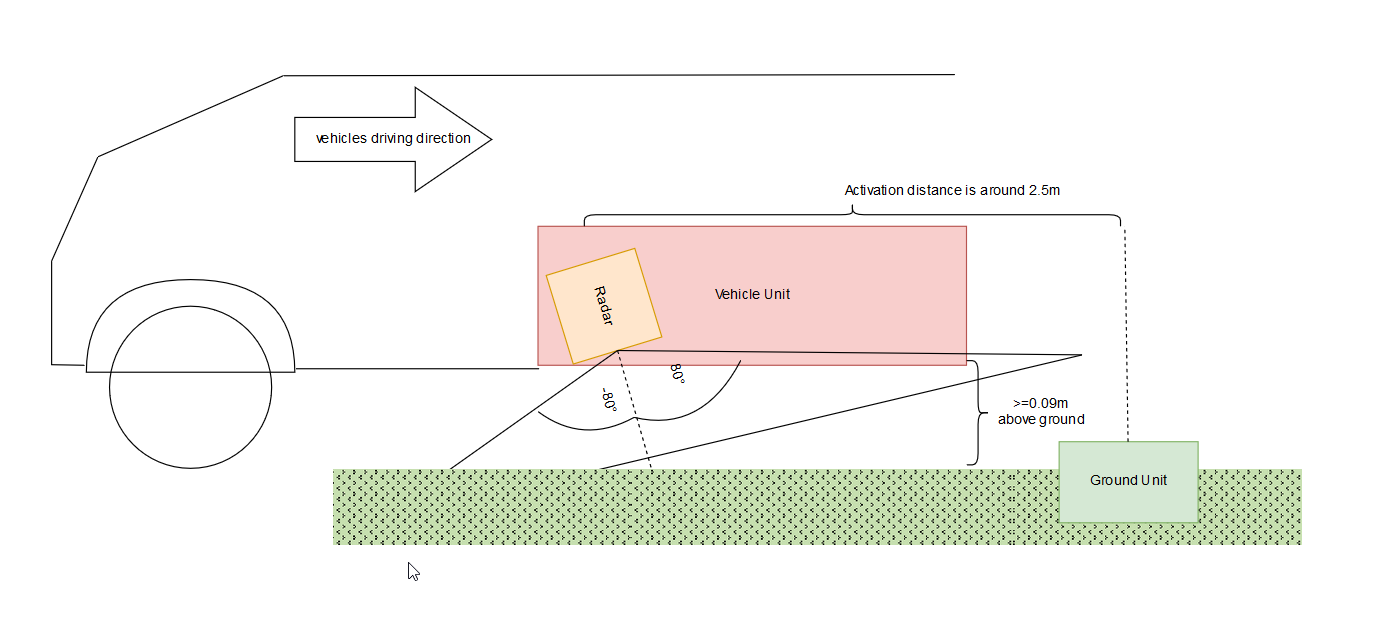

Hi there,
we want to develope a application where we need to detect object installed a the ground.
As you can see the in the sketch. The radar (TI AWR 1843 AOP) faces to the ground and its minimum mounting position is arround 9cm above the ground.
My questions are:
What performance can we assume in the sketched situation regarding massive reflections from the ground?
What is the field of view can we expect? What the is evolution of the radar coils?
Thanks in advance.
