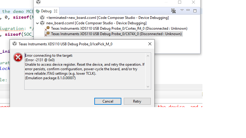

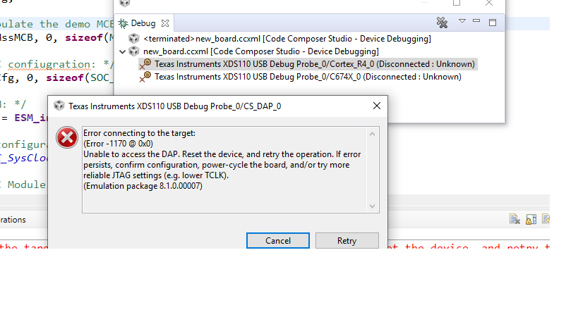

But while debugging, when trying to connect the device, following error is occurring –

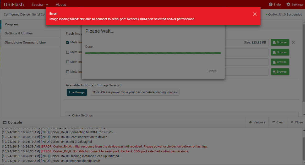

I have also tried to flash the CCS bin file with UNIFLASH. But it is showing the following error –

    5. For Uniflash use, you need to set device in flashing mode (SOP setting 1 0 1) then power on the device.
    Make sure that this XDS110 emulator supports UART-to-USB interface only then Uniflash will able to access to device over UART in flashing mode.

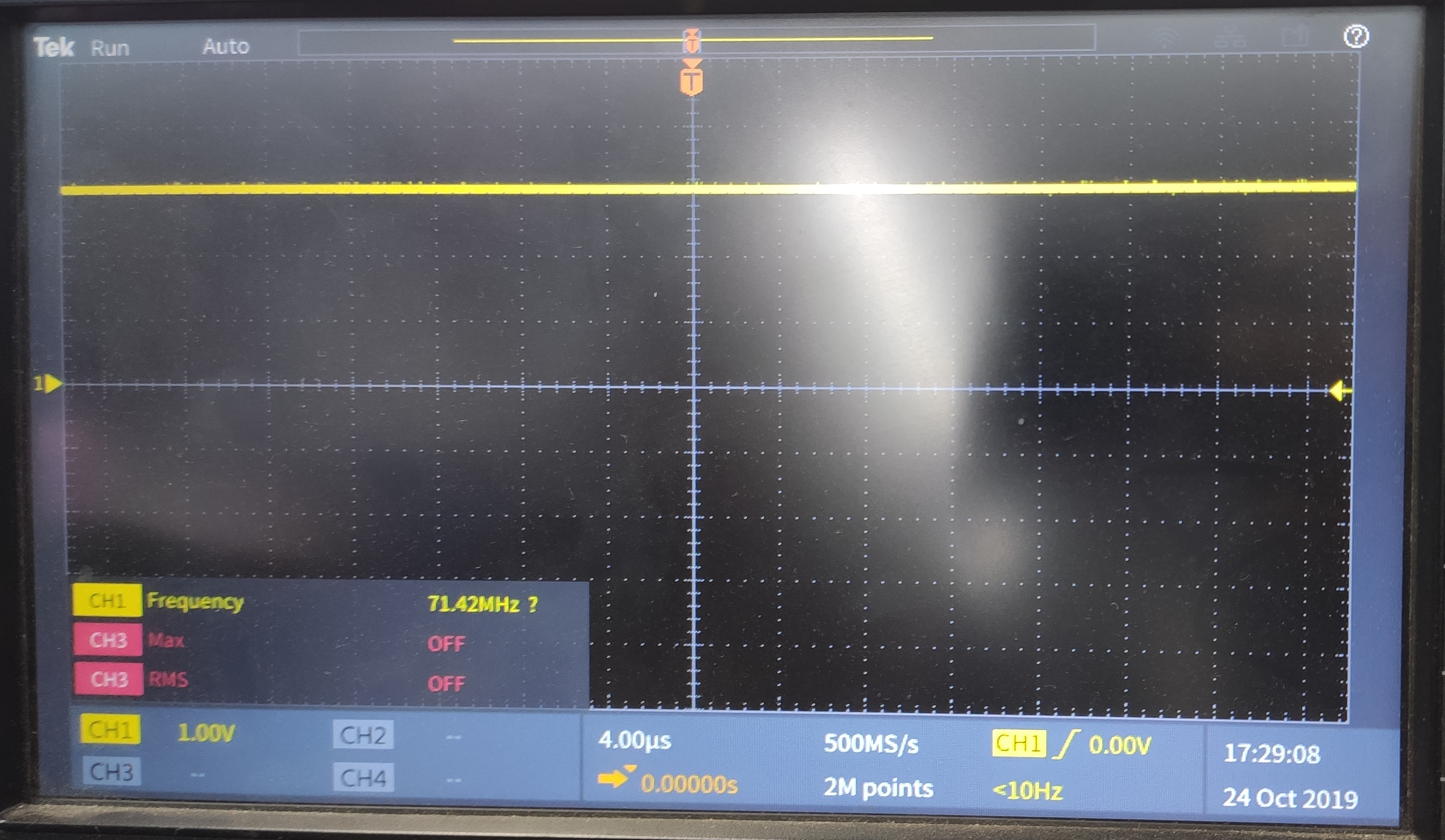

    2. Observed waveform on PMIC RESET signal as follows-

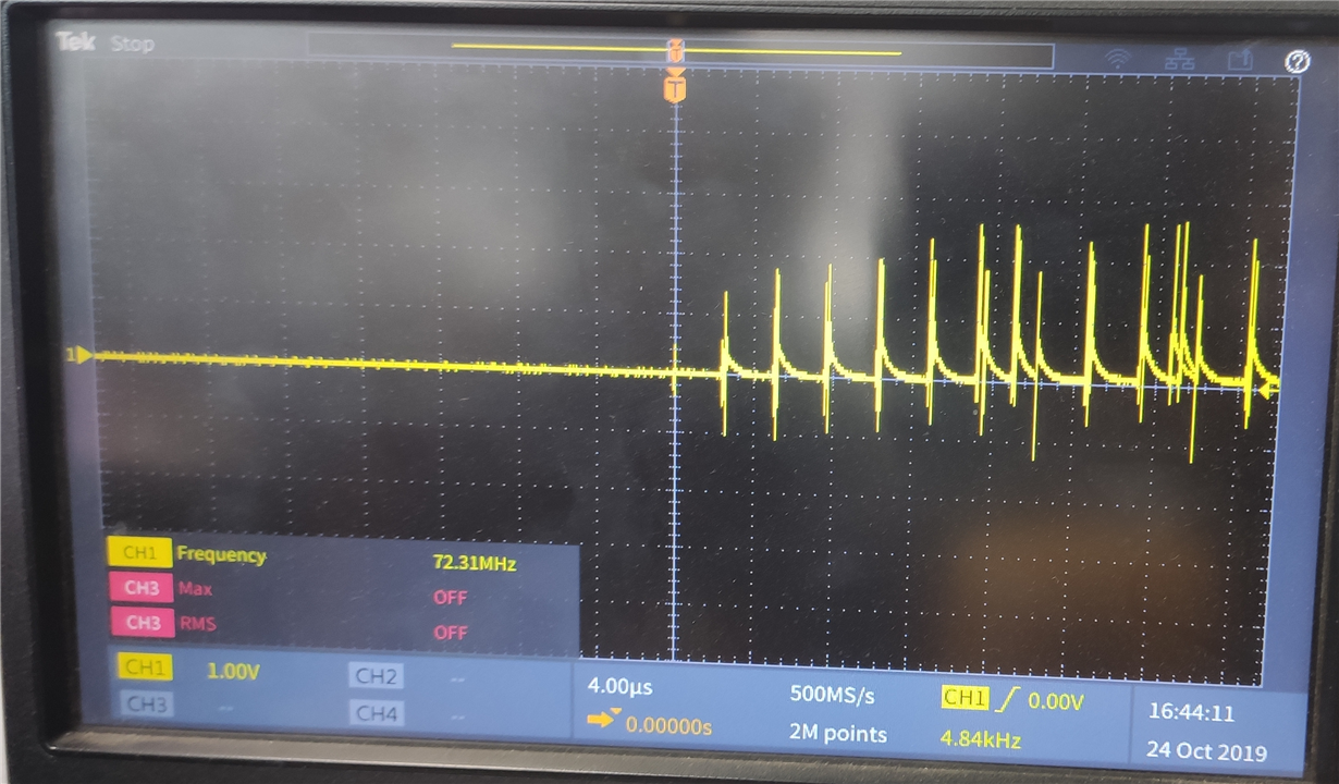

    3. SOP Setting - 100 (Functional mode), Observed waveform on QSPI Clock signal as follows-

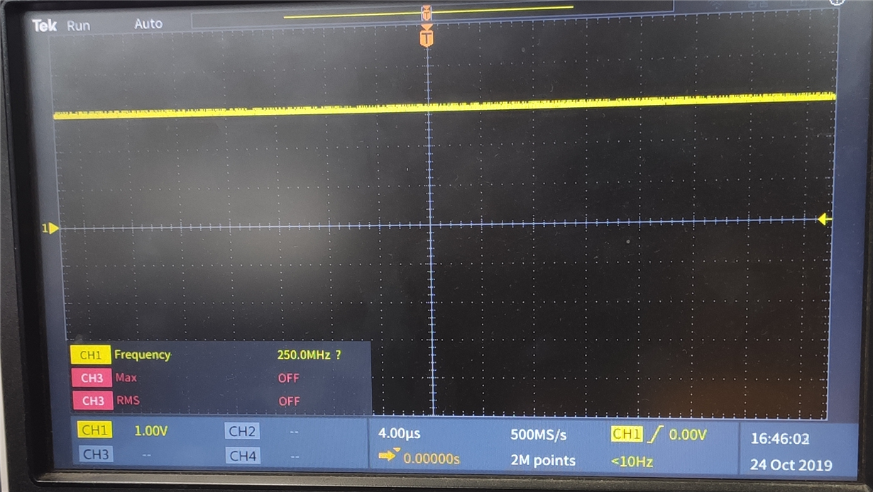

    4. Observed waveform on nError line as follows- (Voltage on line= 3V)
    4. SOP Settings before launching UNIFLASH - 101, but still error occurs which I have post already.
