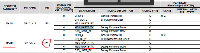

Hi Everyone,
I want to change the functionality of a R4 pin to MSS_UARTB_TX.
In which file and what function should be used to change this functionality?
Harish
Hi Everyone,
Harish
Hi Harish,
Please use TI's PinMux tool to generate the pinmux configuration. You can refer to the Tutorial video provided on the Pinmux tool page to understand the process.
-Nitin
