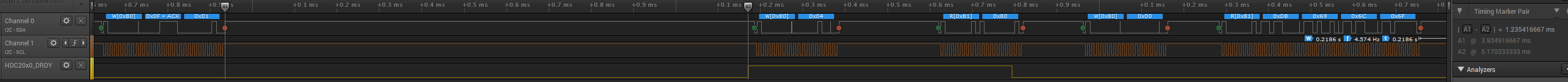

    The conversion time for 14 bit resolution is typically 660uSec for %RH and 610uSec for temp. This is listed in datasheet as conversion time and is on page 5 of the datasheet.
    If you add these together, you will get typically 1270uSec of conversion time for both measurements to be made.
    here is what that looks like in action - click on image to make larger
    what you see here is start conversion command for 14 bit, interrupt fires around 1235uSec later, we read 0x04 register to confirm data is ready, then read out temp and %RH values.
