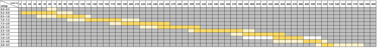

we had measured the visibility of vitalsign in parameter min/max (vitalSignsCfg 0.0 0.5 256 512 4 0.1 0.05 100000 300000)
It shows bigger difference as the distance is further.
Can you guide us how to make it easily adjustable per distance? Our coverage  for the distance from 0.2 to 5 meter.
