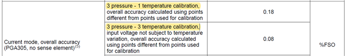

We would like to know Maximum number of the storage of the calibration coefficients.
We understand that number of the storage is “16” because EEPROM is organized in 16 pages of eight bytes each.
Is my understanding correct?
If no, could you please let us know this number?

    There are specific EEPROM spaces for each of the calibration coefficients (these can be found in the PGA305 register map), and the number of coefficients is unrelated to the amount of space in a single page or the number of EEPROM pages.  There are 16 coefficients since they are used for a 3rd order compensation algorithm across both pressure and temperature. Up to 4 coefficients are used to adjust for pressure at each of up to 4 temperature calibration points resulting in a maximum of 16 calibration coefficients.

    Case1 :Can set the 3 pressure - 1 temperature calibration (3points)
    Case2:Can set the 3 pressure - 3 temperature calibration (9points)
    Case3:Can set the 3 pressure - 5 temperature calibration (15points)
    Case4:Can’t set the 3 pressure - 6 temperature calibration (18points (more than 16 points))

    Case 3 is not supported by the calibration algorithm. The algorithm supports a maximum of 4 temperature calibration points and a maximum of 4 pressure calibration points.

    I understand that I can set the 3 pressure - 4 temperature calibration (12points).
    Hide
  • Hi Hide-san,
    That is correct. However, the only calibration modes supported by the GUI are 3P1T, 2P2T, 3P3T, and 4P4T. The PGA305 itself can support 3P4T, but the customer will have to calculate the coefficients on their own.
