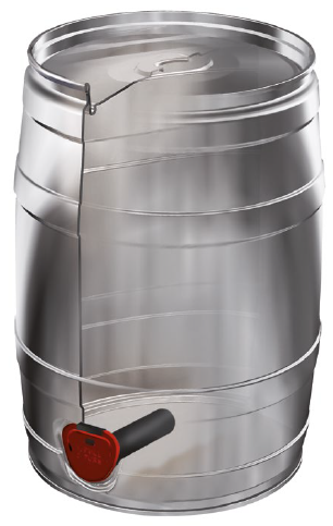

We are using a 1MHz transducer with a TDC1000-GASEVM for level measuring. The transducer was installed as per How to Select and Mount Transducers in Ultrasonic Sensing for Level Sensing and Fluid ID
The container I'm using at the moment is a domestic 5L metal Keg as shown in the image below:

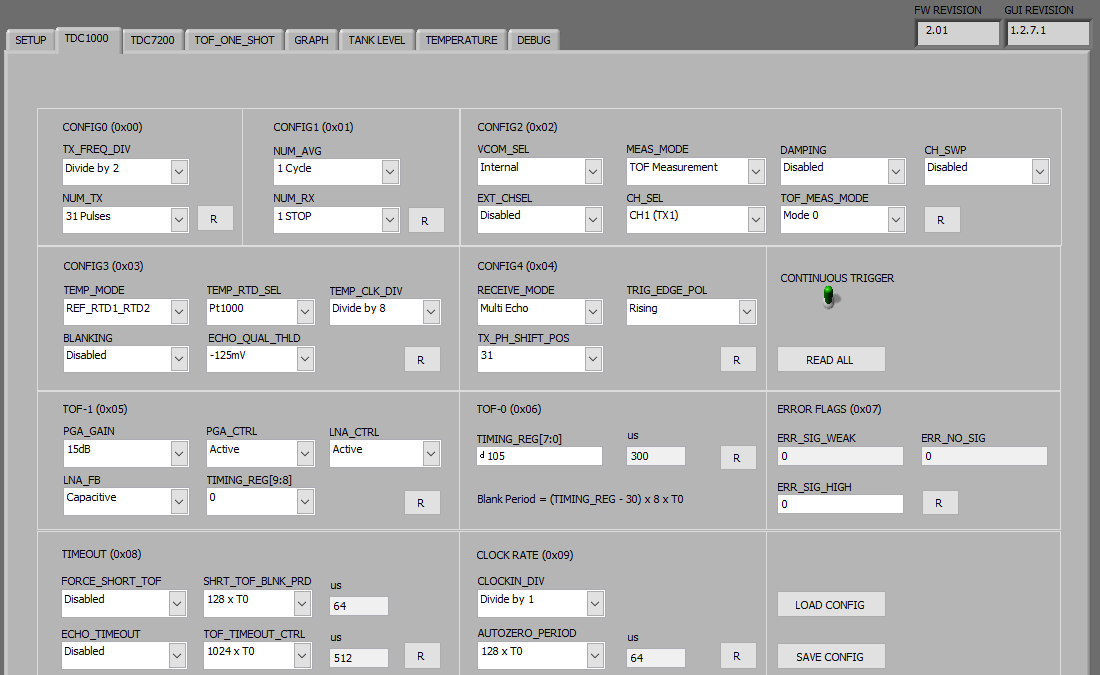

The TDC1000-GASEVM settings I'm using can be seen in the configurations panel below:

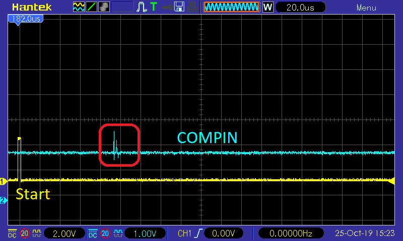

We are able to detect the Echo in the COMPIN without problems when the container is more than half full, but there is always some noise (I'm not sure if that is the Ringdown) in the COMPIN channel as indicated by the red rectangle in the image below (sorry, we only have a 2-channel oscilloscope).
Even when NO transducers are connected to the TDC1000-GASEVM, we can still see a similar disturbance in the same location.

In this experiment, we started with the container completely full and we completely emptied it very slowly (the video is fast-forwarded). The level is successfully measured down to around 10cm, which is when the Echo signal meets the noise detected in the COMPIN channel. After that, "new Echos" are detected
  • What could be a potential cause for this 10cm lower limit?
  • Apart from reducing NUM_TX, what else can we do in order to reduce the minimum detectable level?

    We are sorry for the delayed response. Have you had any more updates to your issue ? Have you had a chance to probe without any connection to the transducer just to make sure there is no noise coupling back into the COMPIN ? Have you made sure there isn't any noise on the power supply ?
  • Hi Arjun,
    1) No. No Updates.
    2) This is precisely what the 2nd Oscilloscope image shows
    3) Noise on the power supply? Isn't all the power from the TDC1000-GASEVM coming from the USB port?
  • Hi Matheus,
    Good and bad news...
    Bad news:
    I am unable to replicate the false-positive result you've observed on your COMPIN pin. You can try to change the LNA_CTRL, TOF_TIME_CTRL, AUTOZERO_PERIOD, and SHRT_TOF_BLNK_PRD to determine if these internal digital triggers are coupling onto your receive path internally.
