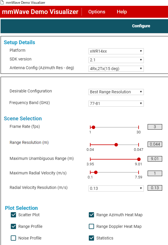

・ Installs a corner reflector in front of the IWR1443BOOST board
・ After configuring with the parameters shown in the figure with mWaveDemoVisualizer,

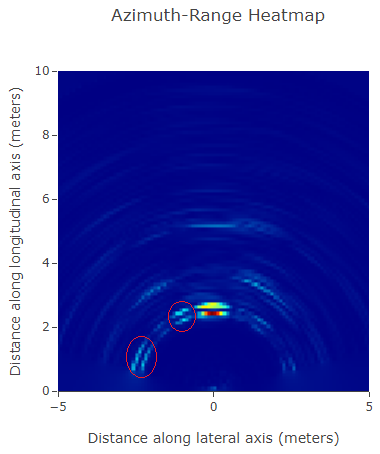

    Display Azimuth-Range Heatmap
In the Azimuth-Range Heatmap, another peak can be seen on the concentric circle of the corner reflector placed in front. (Red circle in the figure)
There is no object at this position, why are these peaks appearing?
