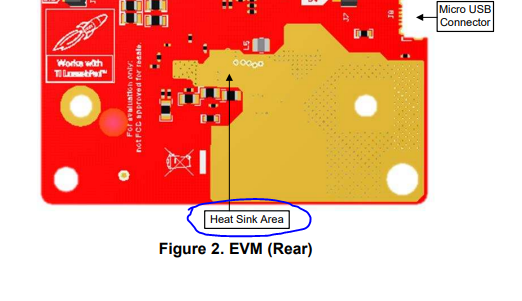

Dear support team:
I found there is a heat sink area introduced by the datasheet (AWR1642 revB).
There are two questions about it:
What’s the heat sink area meaning?
In my opinion, is this area designed for us adding the self-designed heat sink?
Thanks.
Roger
  • Hello Roger,
    You are right. This area basically has exposed copper connected to ground vias connecting to the AWR chip. So you could design a heat sink which would contact this copper area and hence help dissipate the heat from the AWR.
