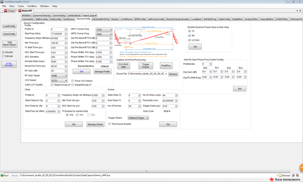

Hi Team,
Customer can configure chirp waveforms and obtain original sampling data of ADC through mmWaveStudio and DCA1000 data acquisition card.  Customer would like to know how to export the configuration in mmWave and import it into CCS project after the waveform verification is completed? Is there an simple way?
    There is no automated way to perform this.
    What CCS project is this customer using?
    If this is a CCS project based on the mmwave SDK demo, then the RF configuration is implemented in the profile file used by the command line configuration

  • Hi Cesar,
    it is MRR project . If he needs to modify the RF configuration of the CCS project, how to verify that the waveform meets the requirements after the modification is completed?
    Thanks.
    In the MRR demo, the configuration is hard-coded in the following file
    mmwave_automotive_toolbox\labs\lab0007_medium_range_radar\src\common\cfg.c
    For the MRR mode, "NUM_SUBFRAMES == 1" and the following configuration applies (profile 0)
    The customer would have to update these values.
