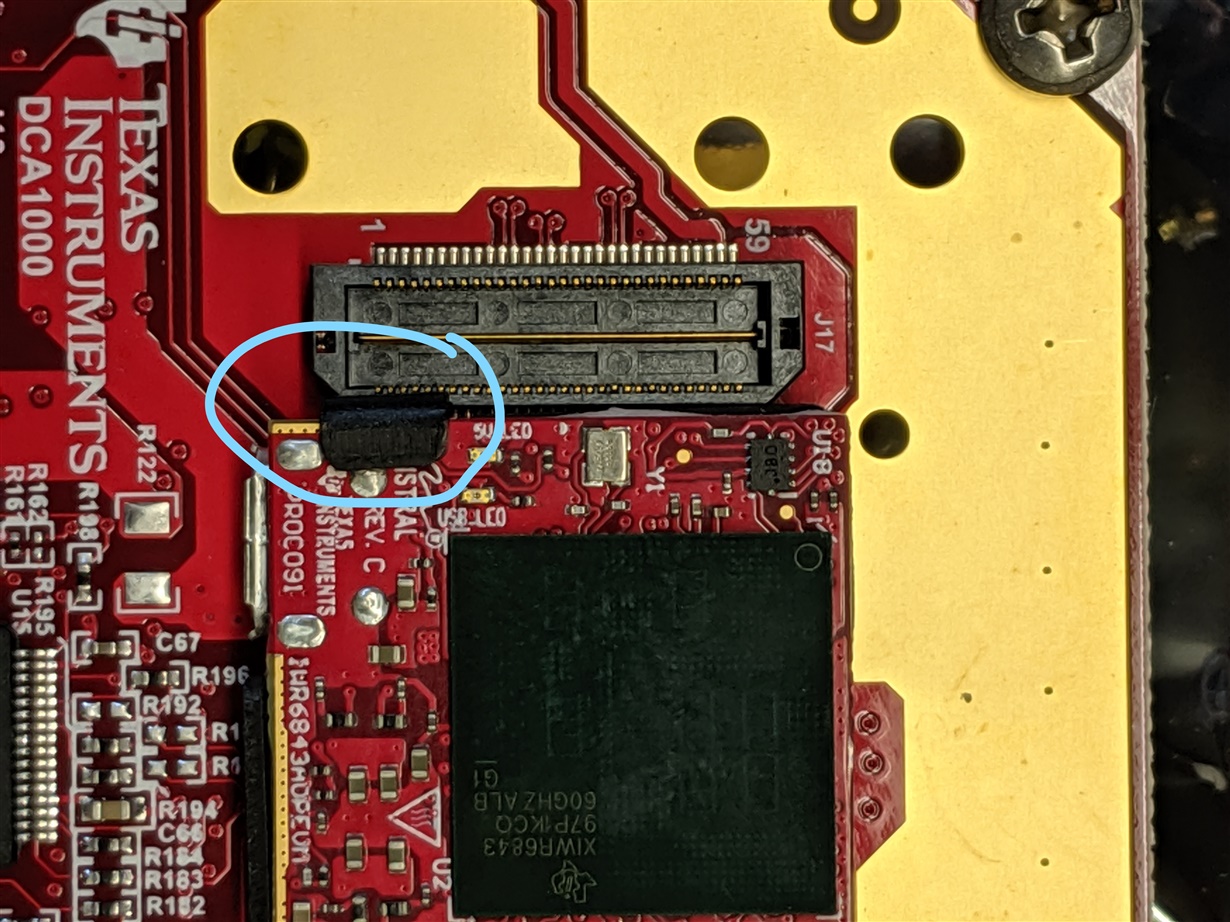

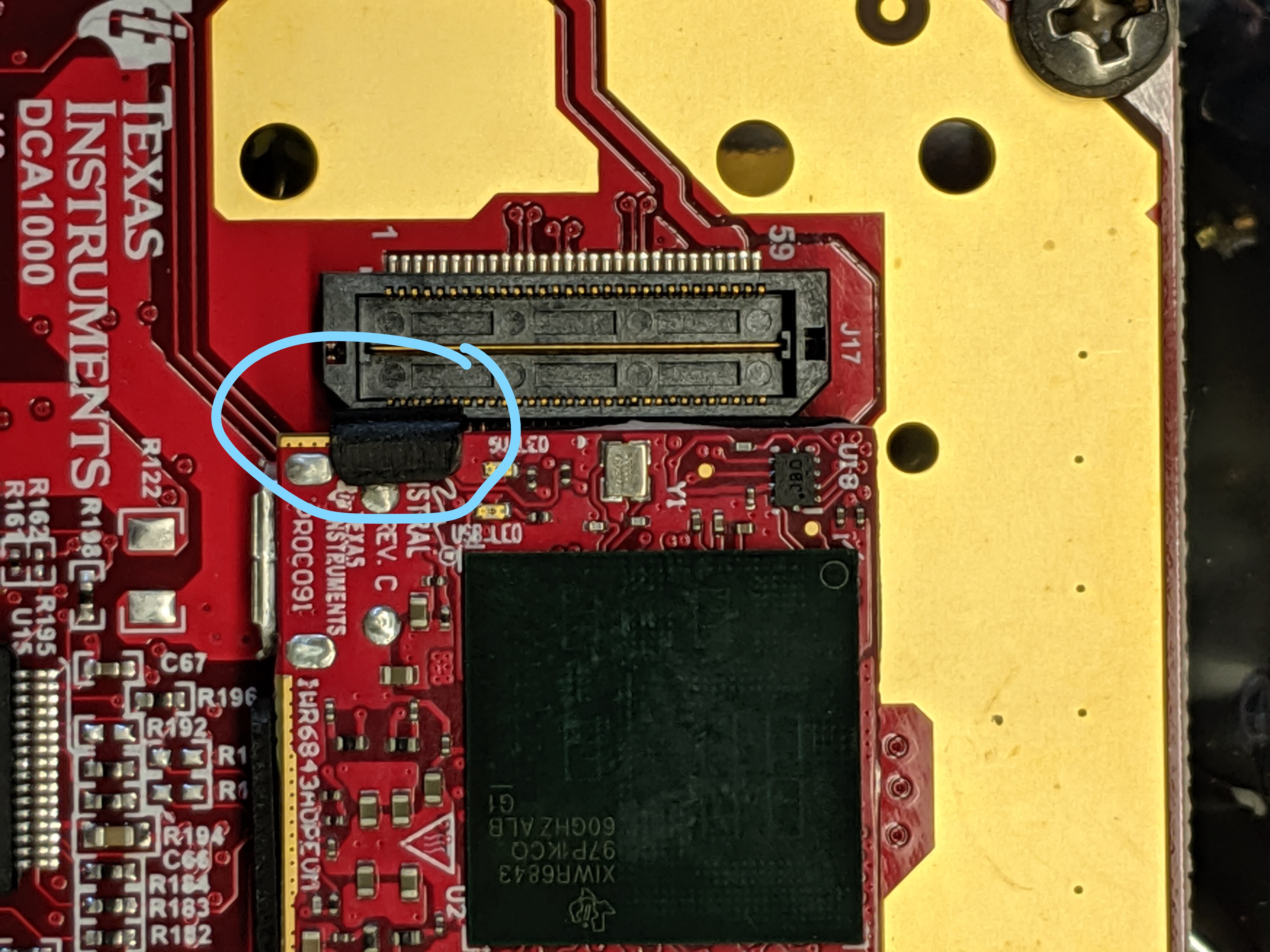

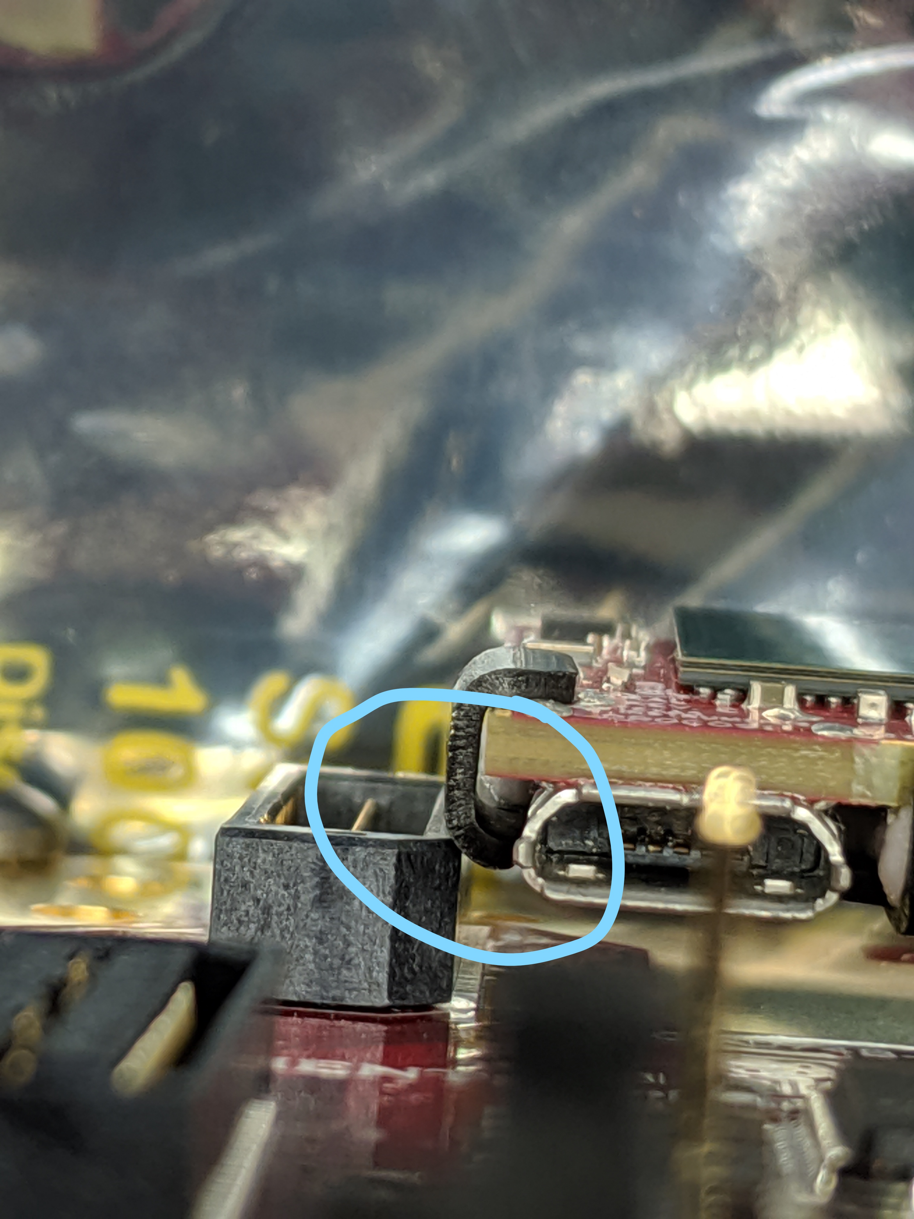

Good morning, just wanted to report a manufacturing issue with the IWR6843 AOP plug in module.  Since the addition of the black heat sink (not pictured in any of the IWR6843AOP literature) it no longer fits on the mmWaveICBoost platform.  See images.  As i do not want to damage the IWR BGA connections by trying to remove the heat sink i think i'm going to have to remove J17 from the mmWaveICBoost board.
