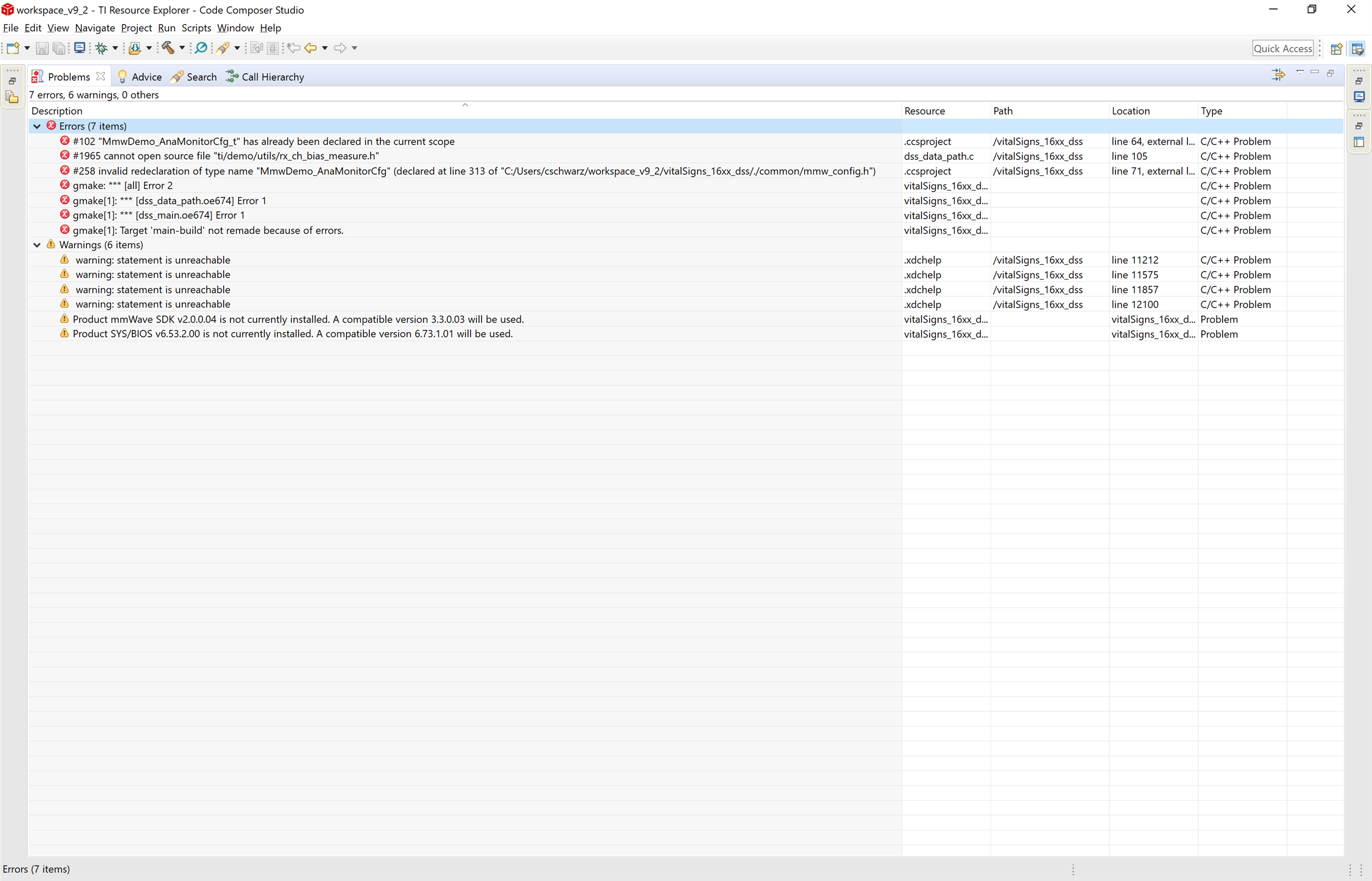

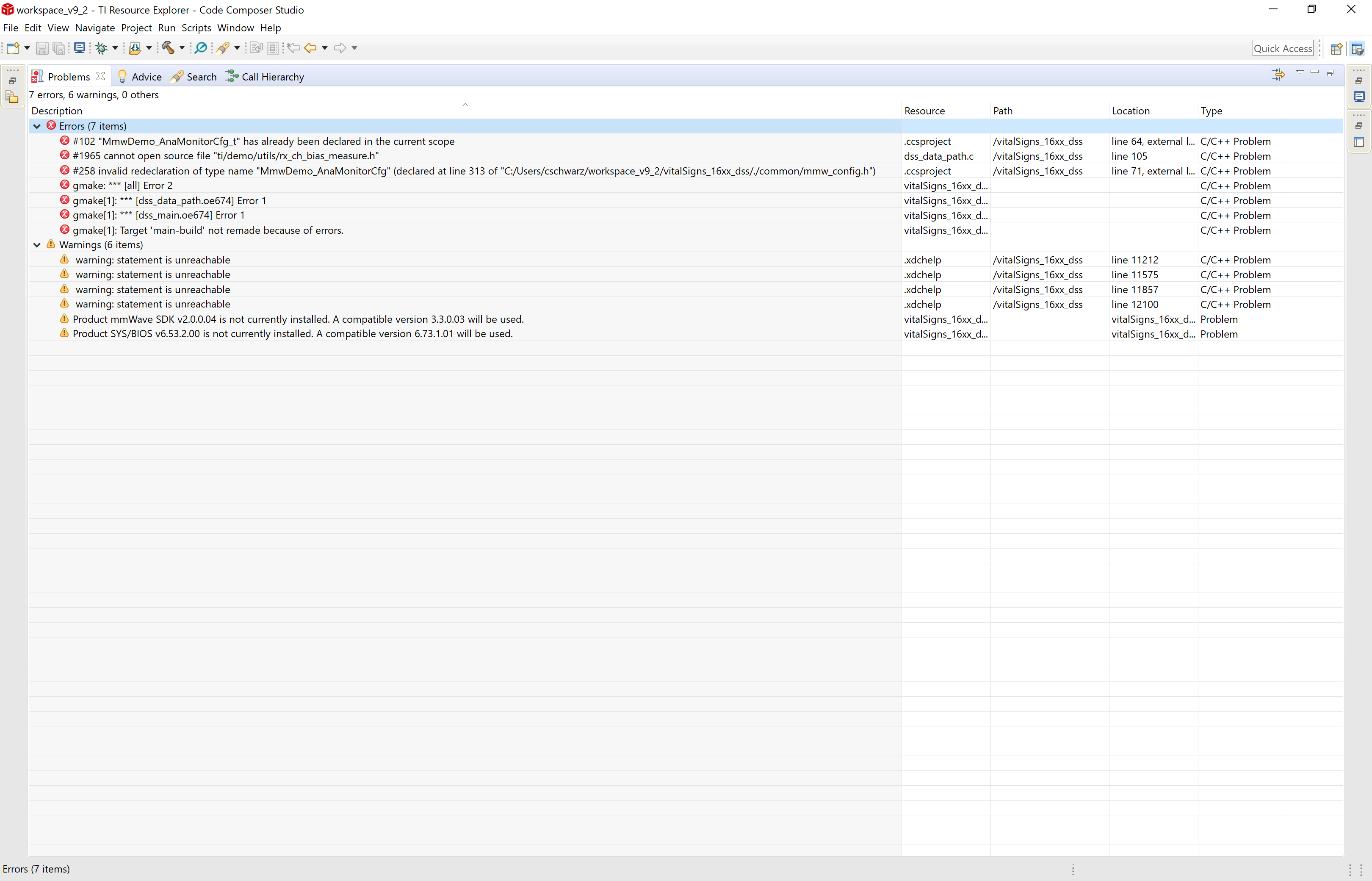

I rebuild the DSS project and get several errors.
I have searched the ti folder for the file rx_ch_bias_measure.h, but cannot find it. I wonder if I failed to install a dependency.  I don't know if that's my only problem, or the first of several...

"C:/ti/mmwave_sdk_03_03_00_03/packages/ti/demo/utils/mmwDemo_monitor.h", line 64: error #102: "MmwDemo_AnaMonitorCfg_t" has already been declared in the current scope
"C:/ti/mmwave_sdk_03_03_00_03/packages/ti/demo/utils/mmwDemo_monitor.h", line 71: error #258: invalid redeclaration of type name "MmwDemo_AnaMonitorCfg" (declared at line 313 of "C:/Users/cschwarz/workspace_v9_2/vitalSigns_16xx_dss/./common/mmw_config.h")
"../dss_data_path.c", line 105: fatal error #1965: cannot open source file "ti/demo/utils/rx_ch_bias_measure.h"
2 errors and 1 catastrophic error detected in the compilation of "../dss_data_path.c".
Compilation terminated.
