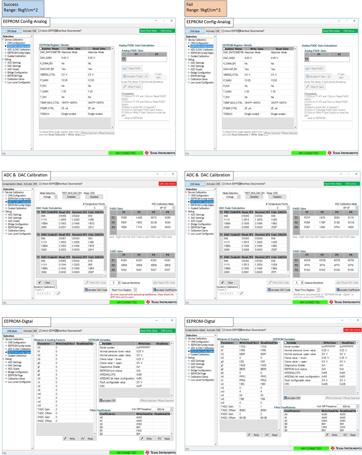

We use PGA300 EVM-034 GUI for getting Internal certification.However, we often didn’t get temperature compensation coefficients that use for pressure compensations. If some conditions that need for calculating temperature compensation coefficients exist, please tell us these criteria.
Measurement conditions
1) 4 pressure points and 3 temperature points
2) Keep each temperature in 3 – 4 hours using by temperature chamber
    (Temperature: -10, 23, and 50)
3) Pressure ranges: 1, 3, and 9 [kgf/cm^2]
4) Applied pressure 0%, 33%, 66%, and 100% in each pressure range
These examples are about success and fail.
  • I couldn’t attached examples files, so I upload these files again.

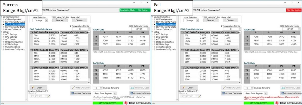

    Were there any other setup differences between the successful calibrations and the unsuccessful calibrations? Can you try a higher value for the PGAIN? For the successful calibration, can you please share the results from the EEPROM Config Digital page?
  • 1)There are no setup differences in success and fail. When I set success and fail products, there internal conditions were same, and also there were in the same temperature chamber simultaneously.

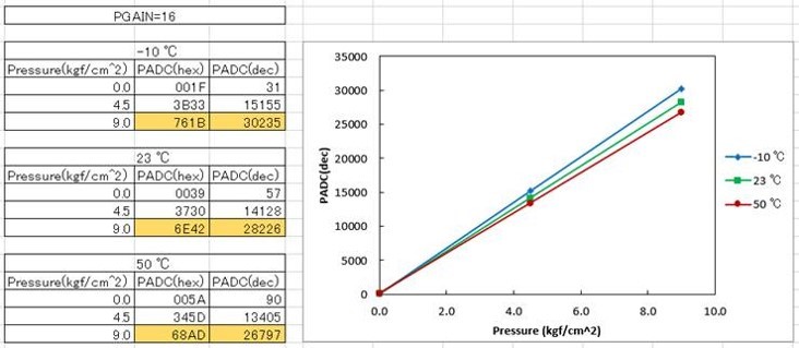

    2)Yes, I can try to a higher value for the PGAIN. However, I’m concerning about not obtaining temperature compensation coefficients. Because I have an experience that temperature compensation coefficients are not obtained, when I set higher PGAIN value (= 16) than current value (= 13.33). I don’t know why that is happen. But PGAIN is set as current value (= 13.33), the probability of obtaining these compensation coefficients is higher than PGAIN value is 16.First image is the setting data that I set PGAIN value 16.
    3)Second images are the reference of test data including EEPROM Config Digital page. Left side and right side images are successful calibration and unsuccessful calibration, respectively.

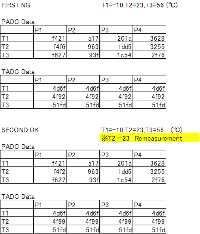

    I will do some testing with manually entering data on my end to try to replicate the issue and better understand it. In the meantime, can you also do a test, and try entering the exact same measured voltage in the DAC calibration section for all 3 temperatures on the failed calibration and see if that affects the GUI's ability to generate coefficients? You can manually enter the same ADC values from your previous calibration to keep everything else the same.
    In the same ADC input values, the results of calculation for compensation was not available.
    When I changed ADC values, the results were turned false to success as follows.

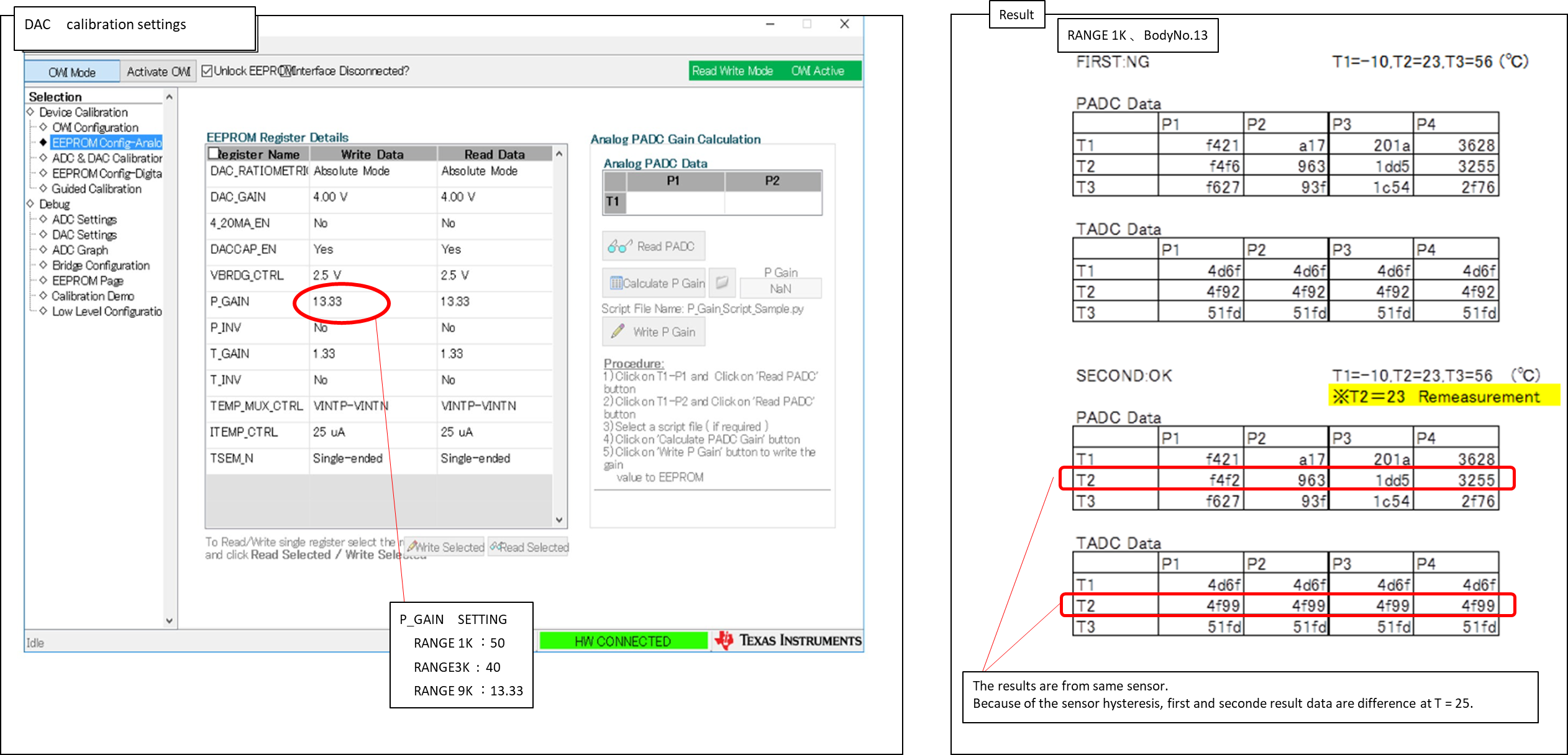

    What are your DAC calibration settings and measurements for these results? Is it the same for both of the examples?
    The DAC calibration setting and result are as follows.
    The measurement sensor ranges have 3 settings that are 1K, 3K, and 9K.
    We secure the pressure characteristic to change P_GAIN.
    Except for changing P_GAIN, oter settings are same.
    The data we posted Nov 6, 2019 2:40 AM is 9K range (P_GAIN:13.33).
    The data we posted Dec 13, 2019 4:15 AM is 1K range (P_GAIN:40).
    I've been able to replicate your findings in the GUI on my end as well. I will need to discuss with some colleagues to see why this might be occurring. There is generally measure of the quality of the fit for the calibration once it is calculated, and it will show an error if the fit is not good enough, but the differences between the two examples is very small, so it's a little confusing as to why it will not go through in this case.

    In the meantime, I did some additional testing, and it appears that the coefficient calculation fails most often when the TADC data for all 3 temperatures are close together. Even if 2 of the temperatures show very similar data but the third is very different it will most likely fail the calculation.

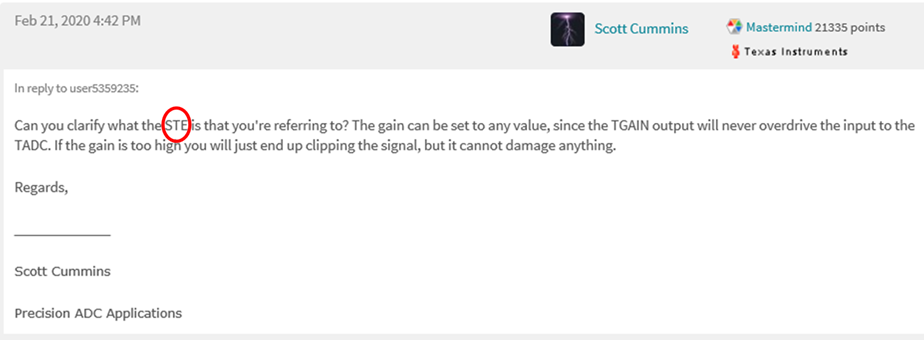

  • Can you clarify what the STE is that you're referring to? The gain can be set to any value, since the TGAIN output will never overdrive the input to the TADC. If the gain is too high you will just end up clipping the signal, but it cannot damage anything.
    Could you tell me the STE? I don't know it. I recognize that the TGAIN value is set from pull-down menu only. Could the TGAIN value be set any value by another method? If it's possible, I would like to know the method.
    When will you tell me the judgement value that is used for distinguishing success and fail?
    I don't understand what STE means. I'm not sure what you're referring to. Can you please clarify what you're asking about?
    The TGAIN only has a few values that you can select. Those are the values from the dropdown. All I meant, is that you can use any of those values safely, and you won't damage anything.

    I received your reply at Feb 21, 2020 4:42PM that's actually includes STE, so I don't understand what it mean. Threfore, I asked you a question about STE.
    I understand TGAIN is only set from the dropdown. The acuired data, that is got with TGAIN value 5, would be saturated.

    I asked because of your message on February 18th:
    I'm sorry for misswriting. I actually wanted to write "set". Incidentally, how is the progress status of the judgement value?
    Ok, that makes sense. I'm sorry for the misunderstanding. I am still waiting on a response from the team that worked on the GUI.
