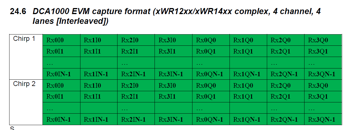

    Is there any information how to encode the resulting .bin-file "adc_data.bin" to process the data in matlab?
    Best regards
    Marc
  • Hi, Marc:
    The data format is listed on section 24.6 of radar studio user's guide at C:\ti\mmwave_studio_02_01_00_00\docs\mmwave_studio_user_guide.pdf:
  • Thanks Zigang,
    so, this is the same data structure as known from the FMCW raw data file.
